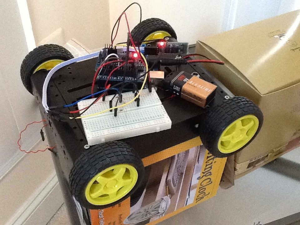

Step 1: Wiring the Charge Switch
Follow the wiring diagram shown. When wiring the charge switch strip the wires and wrap the stripped ends around the hole in the metal prong. After looping the wire in the hole wrap electrical tape around the wire and prong (as seen in the second picture down). If any of these wires make contact with each other it could start an electrical fire (it made a small one with me).
Also, when connecting the wires from the battery pack to the Switch and Charging Socket make sure to use the wires that are coming out of the battery pack, so you do not have to do any extra taping with the electrical tape.
Step 2: Connecting the Switch to the L298N Module
When, connecting the switch to the L298N Module start by unscrewing the screw and slide the stripped wire into the slot underneath where the screw was and then tighten the screw again.
Step 3: Connecting the L298N to the Shield
Start by Snapping the Sensor Shield into the Arduino Uno or Mega (seen in the first picture). Then use the Female-Female wires to connect the IN1 to IN4 to the pins shown in the top wire diagram. Connect IN1 to D7, IN2 to D5, IN3 to D4, and IN4 to D2. Then connect the VCC and GND on the Sensor Shield to the 5V and GND on the L298N.
Step 4: Connecting the Motors to the L298N
To connect each motor to the L298N Module take a red wire and connect it from OUT1 to a prong on the motor. Then connect a black wire from OUT2 to the other prong on the motor. Do this for the other motor by connecting the red and black wires to the OUT3 and OUT4.

Step 6: If the Motor Is Not Working
If the motor is not moving after connecting everything do the following:
- Check to see if the button next to the VCC, GND, and 5V side f the L298N is pushed down because if it is not the circuit will not be on
- Recheck the circuit with the Wire Diagram at the top of this page
- Check to see if you,re batteries have enough power
- Check that the code is correct
- Make sure you were on the right COM when downloading the code
