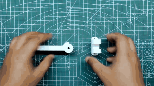

I copied the FAN layer PCB and used it as the display mount layer in the Cad model.
I designed a new PCB to install the 7-inch display using a straightforward lever that tilts the panel because the display had four PCB standoffs at the back.
The rest of the design is the same as the previous Sandwitch Dot IO configuration, which contains three layers connected to each other using four PCB standoffs.
One part of the display lever will be attached to the fourth layer, while the other part will be connected to the display PCB.
We 3D printed both parts using white PLA with a 0.2 mm layer height after exporting the STL file.

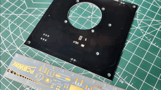

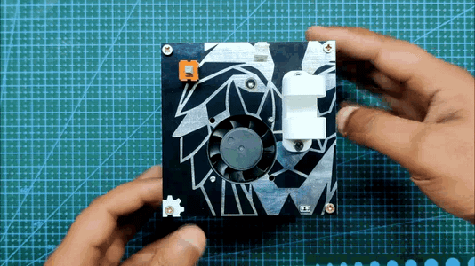

Step 2: PCB Design
Two boards make up the PCB design: one will be attached to the back of the display, and the other is a fourth-layer PCB that functions as a power distribution layer, with CON2 ports on the input and output and a switch in between them to turn the power line on and off.
One LED and resistor are also added to indicate power.
The PCB that is mounted on the display is purely mechanical and contains no electrical components; however, I added a silkscreen of Darth Vader and two open etch tracks so that we could solder the positive and negative poles of the display to them and later add connectors to them for the proper connection of power lines.
Additionally, it has four mounting holes for the PCB to be attached to the display, and four additional holes to attach a 3D-printed lever part to the board. The locations of these holes were determined using a 3D CAD file.
We arrange all the components on the fourth layer board and also create two mounting holes so that the 3D-printed portion can be added.
For aesthetic purposes, I removed the soldermask top layer of the PCB's top etch layer and placed a Wolf Vector image there instead. This allowed the PCB to be coated in the HASL process, which gives off a silver tint.
After finalizing the boards, I send them to PCBWAY for samples.

After finishing the PCB design, the Gerber data for both boards was uploaded to the PCBWAY Quote Page, and an order for a black Soldermask board with white silkscreen was placed.
In terms of overall quality, it was outstanding. Both PCBs contain graphics on the solder mask layer and silkscreen layer, and the quality of this custom artwork is super high.
I've been using their service for a while, and I must say that the PCBs I received were excellent, just as I had hoped.

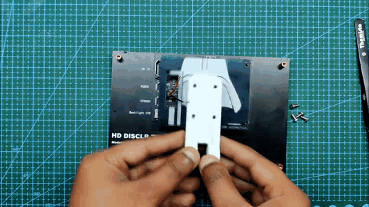

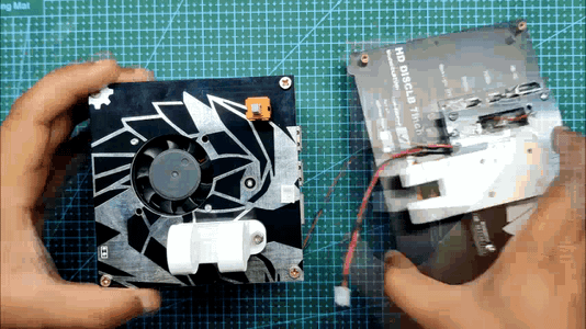

Step 6: Getting Display Ready
  • The Display holder PCB is then attached to its position by first adding one lever and four M3 screws to the PCB.
  • The PCB is then mounted on the display's PCB Standoffs, and the PCB assembly is fastened to the display using four M3 bolts.
  • Finally, we attach a JST wire harness and the Display's VCC and GND to the two exposed etch tracks on the display PCB. The display input is extended by this wire harness, allowing us to attach the display to the fourth layer CON2 Port.

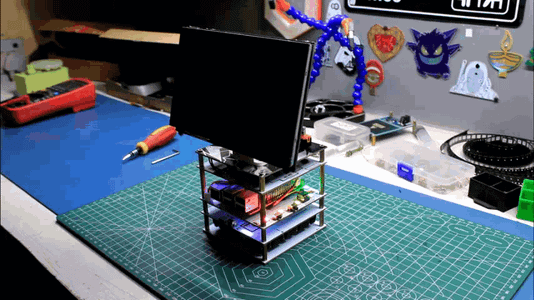

Step 7: Final Assembly

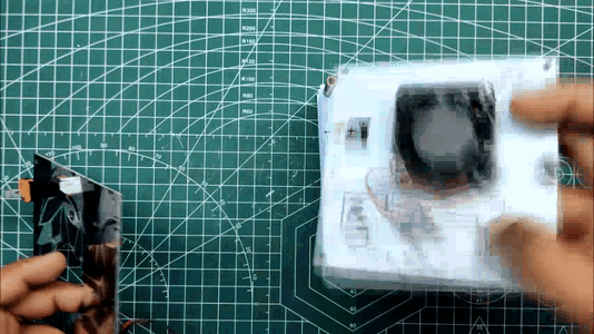

  • We remove the fourth layer from the sandwich cluster and install the 3D Part in its place using two M3 Allen key bolts and nuts. The second part, which will hold the display lever, is added to the fourth layer.
  • After that, we insert the display assembly into the fourth-layer lever component and fasten them together with an M4 Allen nut and bolt.
  • Finally, the sandwich dot io assembly is finished by connecting the display JST wire harness to the JST connection on the fourth layer board.

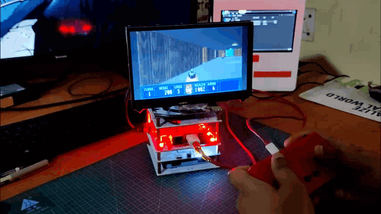

As a result, this arrangement is truly portable thanks to the addition of a fourth display layer, which was made possible by the Sandwitch Dot IO. The display and Raspberry Pi will both be powered by the bottom battery layer.
We need to connect a short HDMI cable from the monitor to the Raspberry Pi in order to use the display. After that, we connect USB receivers for the mouse and keyboard so that we may boot the system and test the entire setup.

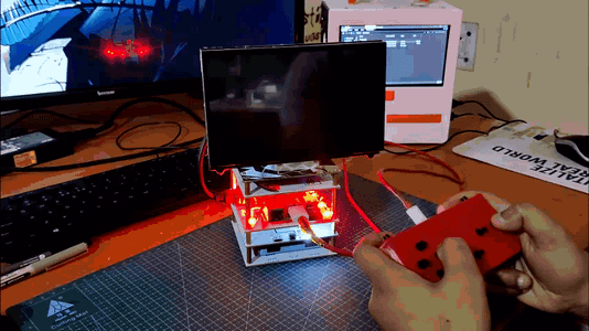

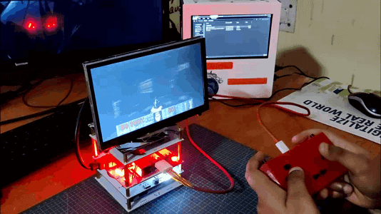

Step 9: Yes It Plays DOOM, As Well As Wolfenstein 3D
Indeed, this system supports doom, including Wolfenstein 3D, which is amazing.
This configuration was created primarily as a retro game emulation station by flashing the SD card with the open-source, user-friendly RecalBox OS, which is based on Retro Arch.

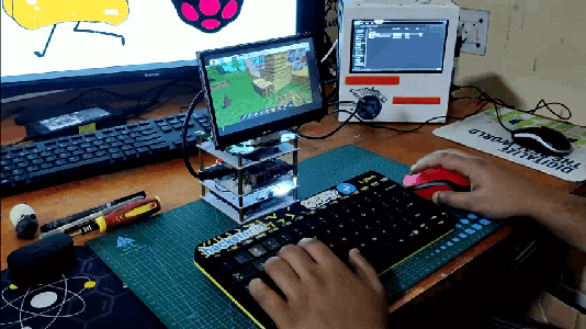

Sandwich dot io functions perfectly, just as it did previously. Since we no longer need to connect an external monitor, the addition of a 7-inch display to the Pi Setup in this edition makes everything much more user-friendly.
To test how well this configuration functions as a PI desktop, we run Raspbian OS, and the first thing I did was install Minecraft.
Minecraft Pi Edition doesn't come pre-installed, so to install it, we first open the terminal and type the below command.
sudo apt-get update
sudo apt-get install minecraft-pi
Once that finishes, Minecraft Pi and the Python library should be installed
Next, in the terminal, we enter Minecraft-pi, and it will open the Minecraft application.
The project is complete, and the game runs without any issues. Sandwich dot IO is simply an overengineered fancy Pi case with a display, power source, active cooling, and LED Lights.
