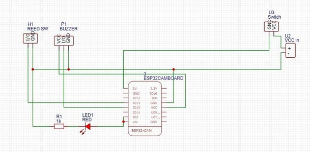

Designing pcb for esp cam that has 5v input and output for 1 buzzer, door magnet sensor, 1 Red LED.

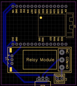

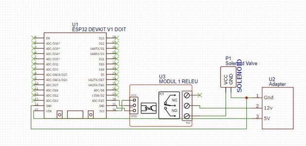

Designing PCB for esp 32 that used to make doorlock system. This PCB needed 12 V input for relay module and 5v input for esp 32.
After that in easy eda convert the design into pcb

In the ESP32 board for the door lock we only use a relay module , solenoid, and power supply. This ESP code below is designed to create a WiFi-connected door lock system using a solenoid, controlled through Firebase, a cloud-based platform. The code initializes a connection to a WiFi network and sets up Firebase for real-time data streaming. It listens for changes in lock state ("LockState") from Firebase, using the onFirebaseStream function to update the lockState variable. When lockState is 1 (indicating the door should be unlocked), the solenoid is activated (door unlocked) for 5 seconds, and then deactivated (door locked), with lockdone ensuring the action happens only once per state change. The system continuously checks the lock state in the main loop and updates the physical lock status accordingly, providing feedback via the serial console.

This Door Locking system functions based on values from a Firebase RTDB Cloud.
Block diagram =
RTDB firebase → Callback function Firebase → Get value of Lockstate → If lockstate =1 activate solenoid for 5 seconds, if lockstate = 0 don't activate solenoid → loop every 2 second.

We use 3D printing with PLA material for the case. The 3D print is customized to fit and contain the ESP which is used for the door lock or solenoid system. The 3D print has a dimension of 12mm x 12mm x 8mm followed by 11mm x 6mm x 11mm with a thickness of 5mm to contain the ESP32 as mentioned before. The 3D print case also has 2 holes in the back side, each hole having a dimension of 15mm in diameter. The holes are used to arrange the wire in which the upper hole is used to power the ESP32 cam through the ESP and the lower hole is used to configure as well as to power the solenoid system using the ESP32.

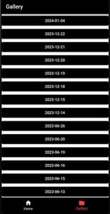

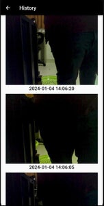

We make a mobile apps using flutter language. The apps can send boolean 0/1 to verify state in esp 32 cam and receive jpg data from firebase. We make 3 pages. The first one is to view updated image and to open or close the doorlock. The second pages apps is to view history that devided in terms of days-months-year. The third pages is
to view the list of photo that taken in the date that selected.
