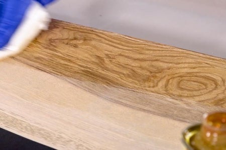

• Table legs of your choice and Danish oil

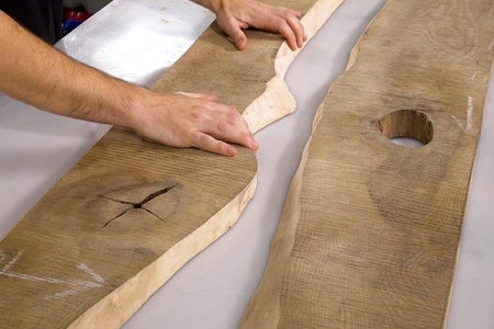

  • Cut the slab down the middle - your supplier may be able to do this for you. Then when you flip the planks - placing the live-edges to face each other - this will create the river channel
  • Remove any loose material from the live-edges, like bark using a mallet and chisel
  • Key the live-edges using a coarse abrasive paper (120/240 grit), this will result in a good surface for the resin to bond to
  • Then clean the surfaces and area, to ensure no dirt or dust remains

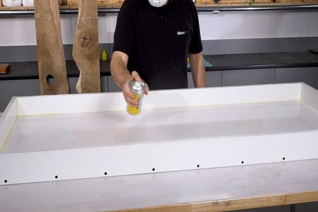

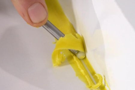

  • Make the box watertight using filleting wax - pushed into the cracks and corners
  • Finally, apply release wax to the surface (according to the product instructions), this will ensure a clean release

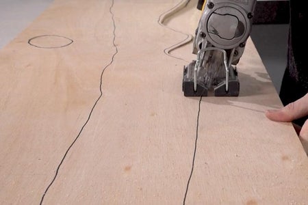

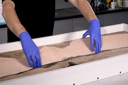

Step 3: Creating the Plywood Core
Up to this point, the project follows a traditional river table process ... at this point we'll show you how to incorporate our amazing resin and money saving method - creating and inserting a plywood core!
The core is intended to take the place of the bulk of the resin you would ordinarily require, the aim of this step is to create a core that will mean that you will only need a 5mm (1/4 inch) resin pour around the core.
The size - thickness, width and length of the core - will depend upon the size of your slabs and the overall size of the table. We used a 24mm depth board, and our plank depth was 34mm, allowing for the 5mm resin pour top and bottom.
To create the core:

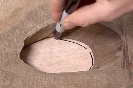

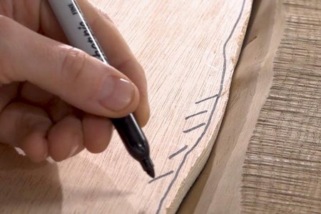

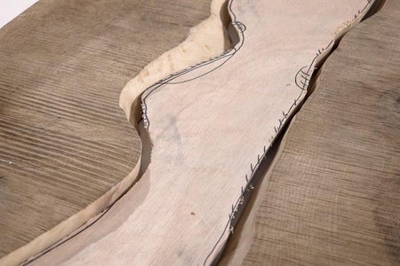

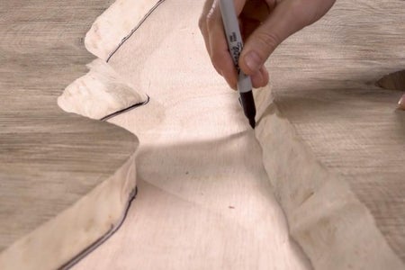

  1. Begin by tracing the profile of the live-edge slabs on to the plywood sheet, including large knot-holes and cracks - as these can be deceptive and take up lots of resin
  2. Give consideration to the angle of the waney-edges - you may need to set your jigsaw on an angle
  3. Cut out the core
  4. Make adjustments to the core if required - e.g. the angles

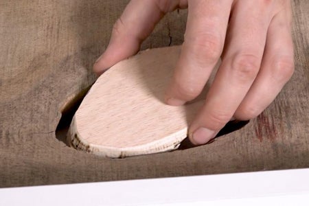

  5. Create mini cores for sizeable knotholes or crack
Don't forget to allow for the 5mm gap on the top and bottom of the core and around the sides so that it will be fully encapsulated.

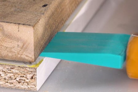

When making sure that the core 'fits well', use lollipops to lift the core by 5mm.

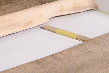

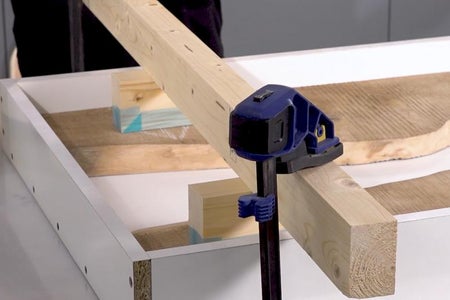

You are now ready to set the planks up in the mould box - using some wooden blocks covered in resin release tape and some clamps, fix the planks securely inside the mould box to stop any resin creeping under the planks.

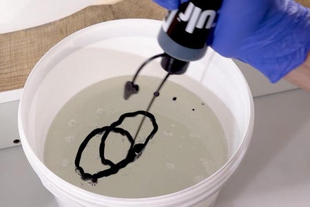

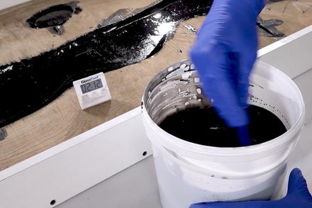

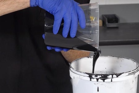

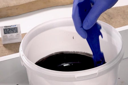

To ensure the resin you work with throughout the project is a consistent colour, we advise pigmenting all the resin (Part A) before mixing it with any hardener.
Pour the resin into a container that has a lid and add the pigment of your choice. We used a solid black epoxy pigment and added 5% - make sure you follow the manufacturers instructions. Mix the pigment thoroughly into the resin, making sure you scrape the sides and bottom of the pot and wipe some pigment across the pot to see if the colour is solid enough.
Mixing

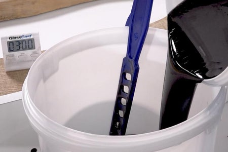

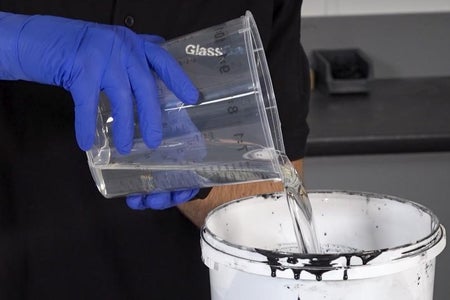

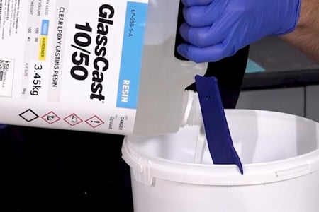

It's now time to mix up the resin for the first pour. The depth of this pour needs to be 5mm and will form the base layer and the sealing coat of the live-edges. To calculate how much you will need take the length, width and depth as follows:
1.5m (length) x 0.2m (width) x 5mm (depth) = 1.5 litres

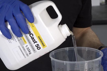

Using GlassCast 50 which has a 2:1 mix ratio means that we need to mix up 1 litre of resin and 500ml of hardener of GlassCast 50.

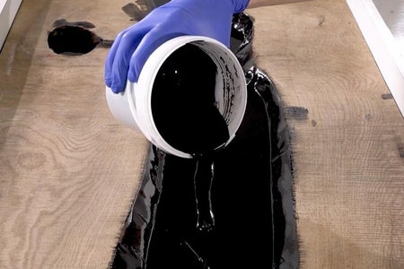

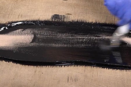

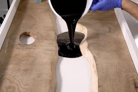

Step 5: 1st Resin Pour
Using calibrated cups measure out the pigmented resin and the hardener and mix slowly and steadily for 3 minutes, periodically scraping the bottom and sides of the pot. Then transfer the mixture into a clean container and mix for a further 3 minutes - we call this double-potting and it helps ensure that no unmixed resin gets on to the project.

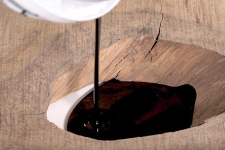

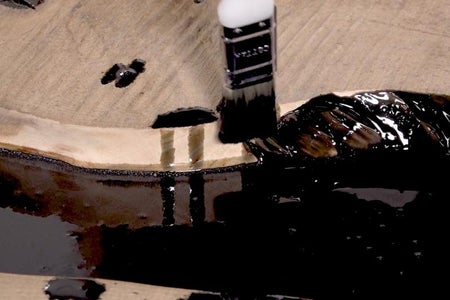

Pour the mixture into the base of the mould box (and knotholes if you have them) then using a brush paint the live-edges to seal them and leave to partially cure for around 12 hours at 20°C.

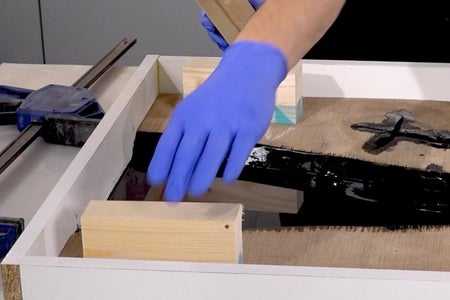

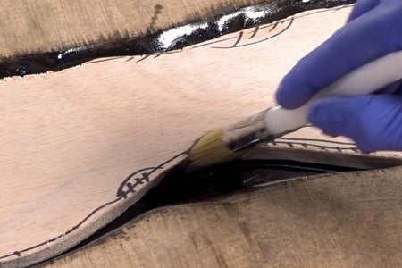

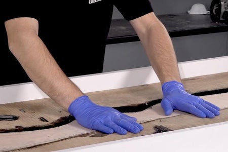

Step 6: Inserting and Sealing the Core

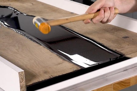

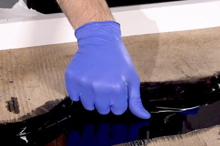

The first pour should have cured to the B-stage, to check this you can use a gloved finger and press the resin surface. It should feel firm but tacky but no residue should stick to the glove.

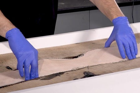

The clamps and blocks can now be removed and the core can be inserted and sealed. Mix up a small batch of the pre-pigmented resin - the quantity will depend upon the size of your project. Follow the double potting mix method again and pour the majority of the mix into the river and the knot holes if you have created individual cores for these.
Next, carefully place the plywood core into the river channel, lowering one side into the resin, then the other side before gently pressing the core down along it's full length to push out any air bubbles.
Once the core is in position, use a brush to seal and coat the sides and top surface, then leave to cure for a further 12 hours.

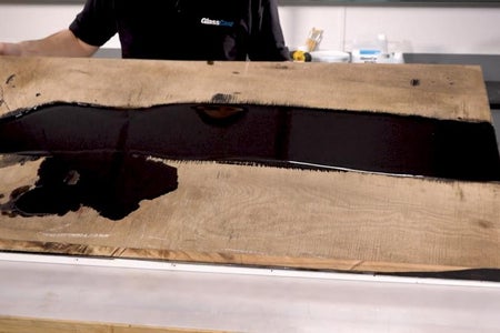

Step 7: The Final Resin Pour

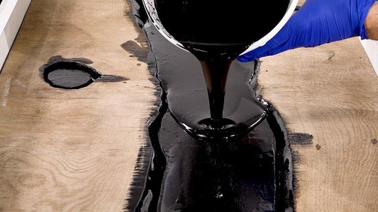

Check the resin has once again cured to the B-stage before mixing up the final batch - once again following the double potting method.
Slowly pour the resin into the channel and any knotholes/cracks - this pour should bring the resin level with the top of the wood.
Leave the resin to fully cure - for GlassCast 50 this is 48 hours - but check your product datasheets.

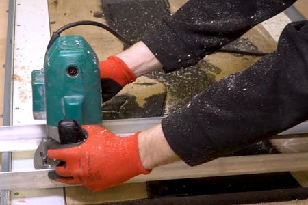

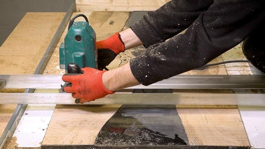

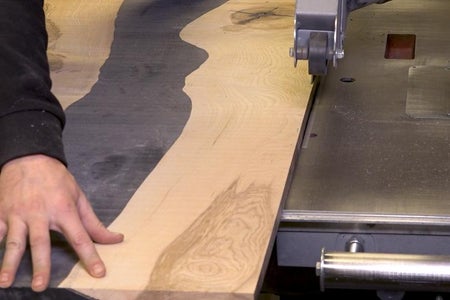

Step 8: Machining the Surface
Check the resin has fully cured, then remove the slab from the mould box - if you prepared the box well it should release easily.

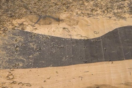

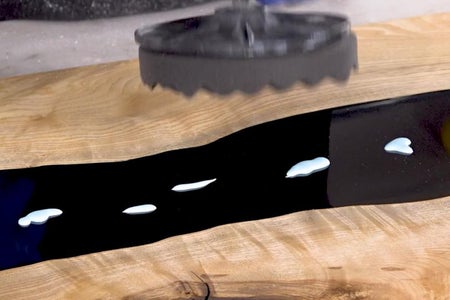

To machine the surface, we set up a router on a sled and completed several passes over each side of the slab the trimmed the edges on a table saw.

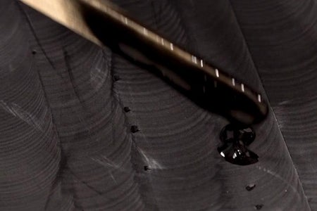

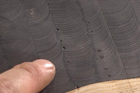

After routing we noticed a few small imperfections - tiny chips in the resin surface which we think was possibly caused by moving the router too fast - if you have any imperfections simply follow these instructions:

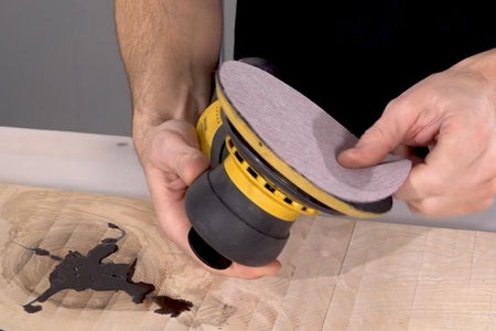

  • STEP 1: Before filling any small holes or imperfections, thoroughly clean the surface using a vacuum cleaner and if necessary, wash and thoroughly dry the surface before moving on to the next step
  • STEP 2: Mix up a very small batch of resin and hardener and add the pigment to match the main pour as closely as possible. Then using a lollipop stick, carefully drizzle the mixture into the holes and allow to fully cure (for a further 48 hours) before moving on to the flatting and polishing stage

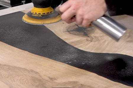

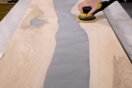

Step 9: Flatting and Polishing and After Care
Once the repairs have fully cured, the flatting and polishing can begin:
Flatting
Using a Dual Action Orbital Sander (DA) will make light work of a job like this one.
We advise working through the grits from 240 grit, up to 1200 grit.
It's important that you don't move on to the next grit until all marks are removed from the previous one or skip grits and when you get up to the finer grits on the resin we recommend wet sanding.
We are asked about sanding and polishing so often that we compiled a special tutorial to help people get great results which you can view in another of our Instructables here!
Before moving on to the polishing stage, we recommend protecting the wood from the polishing compounds you will be using. This helps to avoid staining the wood whilst polishing the resin. There are lots of products readily available from DIY stores - it really depends upon the appearance of the wood you're aiming for - we used Danish Oil which we simply applied in a few coats on a lint-free cloth, allowing it to fully dry before moving on to the final stage - polishing.

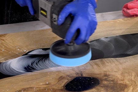

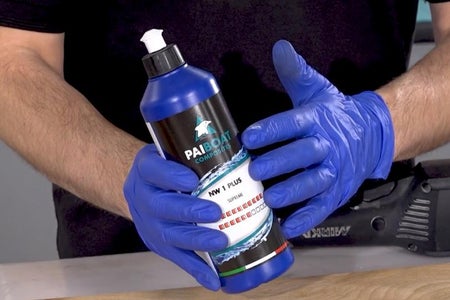

Polishing
Using a power polisher and foam pads we applied a polishing compound to the resin river to bring it to a full-gloss and finally to give it an extra shine we applied our Topfinish gloss compound to give it the wow factor!

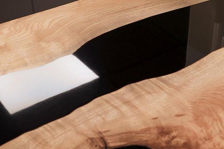

Step 10: The Finished Table
The final step was to attach the legs and it looks incredible!
The amount of resin used on a traditional river table build was cut to 1/3 which saved so much money and materials, without compromising on strength. This is a fantastic 'hack' which can be used in any solid colour or metallic effect!
So if you're interested in making your own resin river table at a fraction of the usual cost - this is the project for you!
