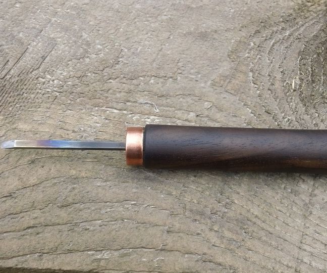

Step 6: Optional Engraving, Inlay and Patination
These are purely optional however even a slight engraving or patina coloration can enhance the appeal of something.
For this project I chose to do a bit of engraving and some patina coloration along with a brass heart inlay into the center.
The brass heart was carefully cut out, filed and then hammered into place.
Other finish work was a light sanding and a dip into a patina solution I made.
