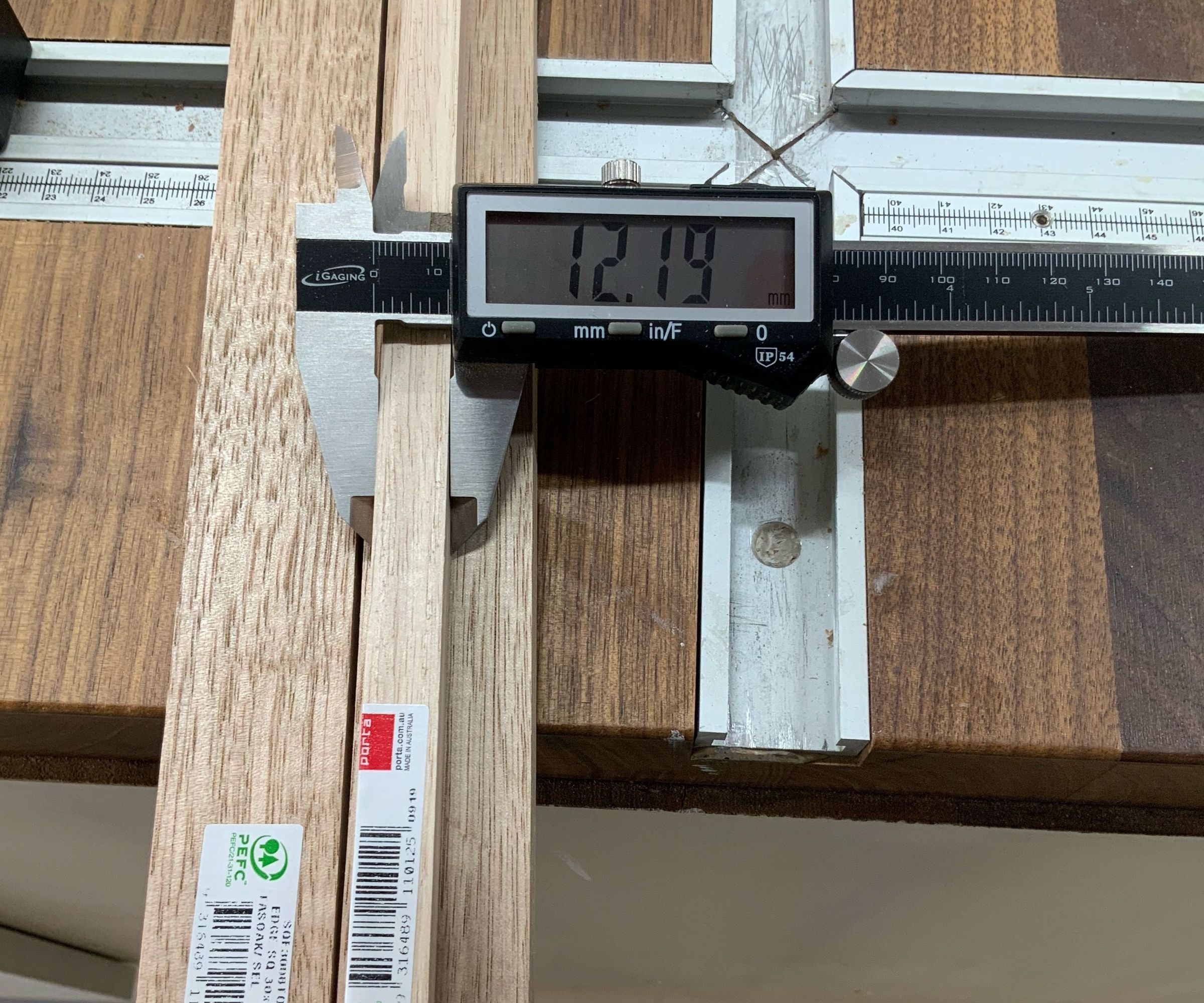

Scrap wood of any thickness greater than 12mm (1/2") for the body.
3 ply or thin wood scrap for the tail
