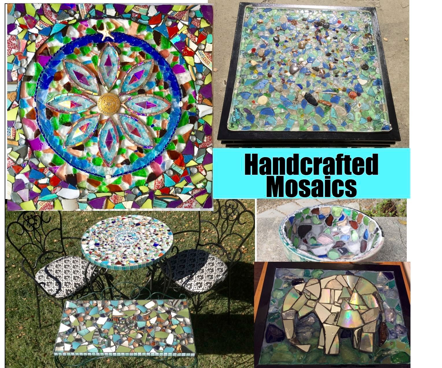

- The round tabletop with grey grout has a more even top made up mostly of flat or thin pieces of sea glass and shells
- The rectangular tabletop with black grout is has a bumpy top and features broken pottery and thick pieces of sea glass of various sizes (this was my practice piece for me)
