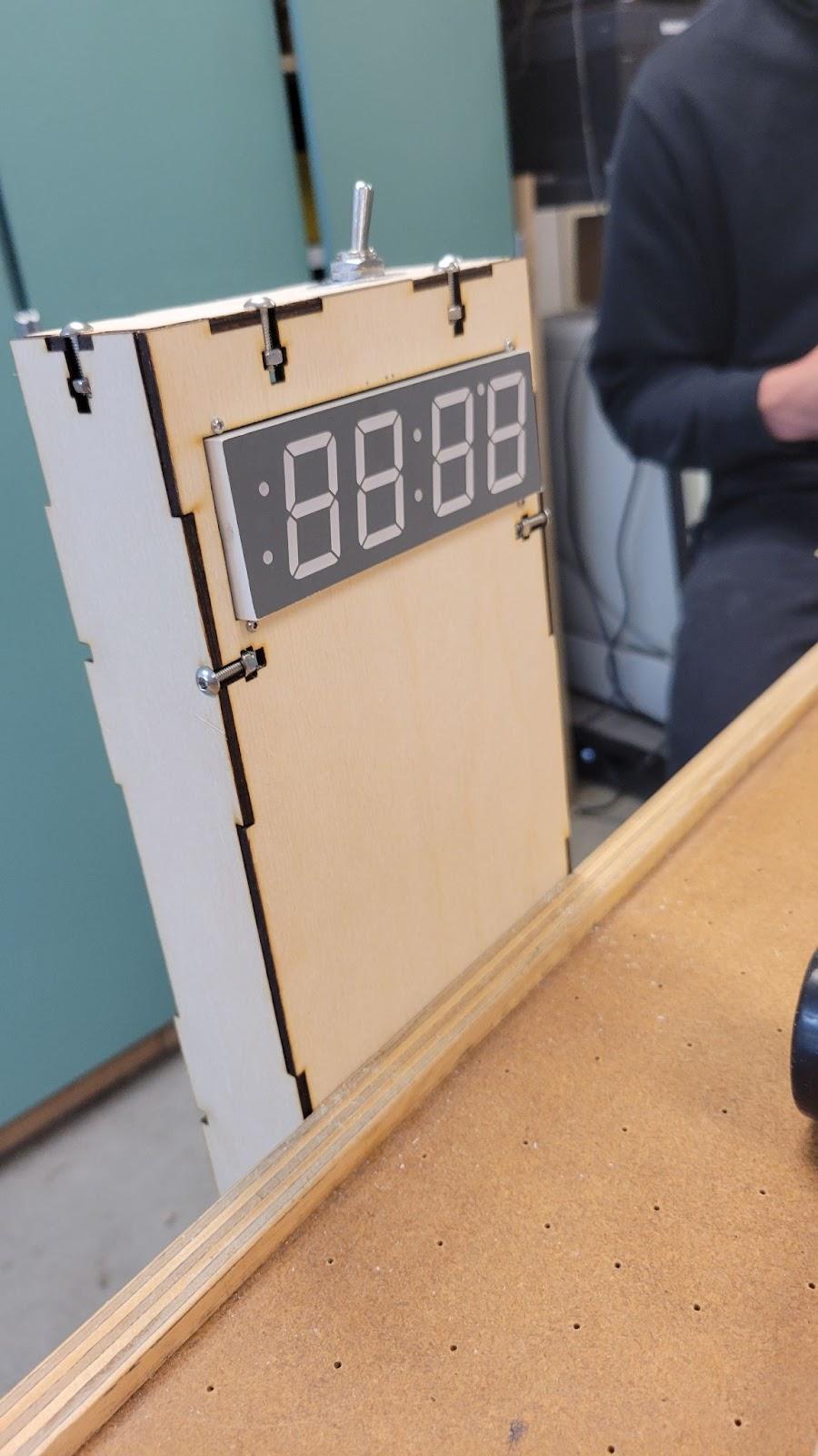

Step 13: Constructing the Scoreboard
Another part of the hockey table we changed was the scoreboard. The Air Hockey Table’s scoreboard is essentially just a box. It consists of a few holes for 2 USB cables which connect the goals to the box, as well as another hole for the power cable. It also consists of a pre-cut hole for our scoreboard screen to sit in. I made the box through MakerCase (https://en.makercase.com/#/) so that it would go together and come apart easily. (this will pre make tabs so the box can be assembled easily) The box is 12 inches tall, 5.5 inches wide, and 2 inches deep. The holes for the cables are about 0.25 inches wide and 0.5 inches tall. This makes for a pretty nice fit. The scoreboard’s hole for the screen is 1.625 inches tall and 4.75 inches wide. This gives it a nice tight and flush fit. The laser files for this box can be found HERE

Step 26: Coding
Note: We are still working on the code for the scoreboard however the code for the LDR does work and it does detect the value changes.
