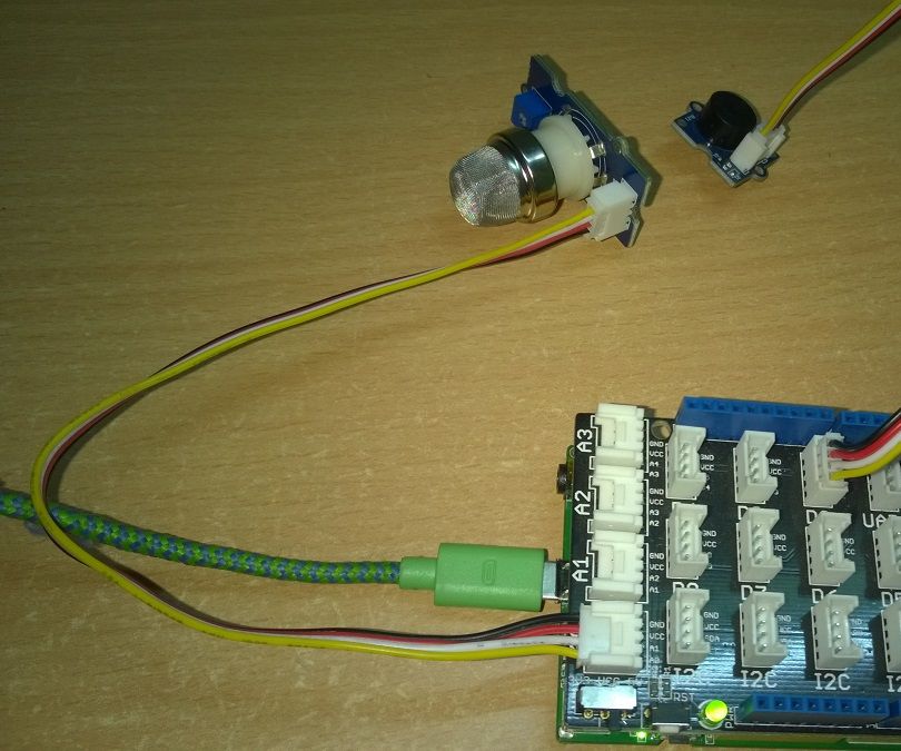

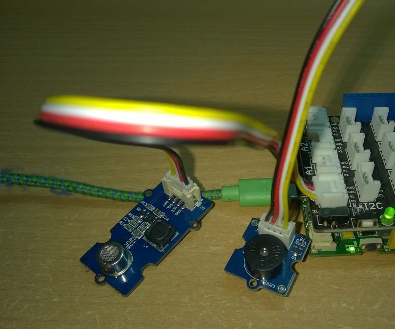

Step 2: Making Connections and Programming
1. Connect your Edison to power supply and to your PC via USB cable.
2. It will take 15-20 seconds to boot up, after that stack the Grove Base Shield.
3. Connect the PIR motion Sensor to analog pin D2.
4. Connect the Buzzer to pin with PWM, I connected to D5.
5. Connect the LED to pin D3.
6. Open Intel XDK IoT edition, if it is not already installed in your PC get it from here. If you have flashed you Edison with the Flash Lite Tool Node.Js will be already installed on your board.
7. Connect IDE to your Edison board. It will ask you for username and password, default username is root with no password.
8. Select a blank Node.JS template and create a new project.
