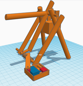

Introduction: Servo Driven Counterweight Trebuchet
The project is a counterweight trebuchet, i.e. uses a heavy weight and leverage to throw projectiles.
A continuous rotation servo is attached to the winch axle to bring the arm down by winding the rope as the axle rotates. The servos are driven by a Raspberry Pi Pico W that connects to a local Wi-Fi network so that an online dashboard can be used to control them through Adafruit IO.

IMPORTANT DESIGN CHANGES FOR VIEWERS: A trigger mechanism is also included that attempts to push the rope attached to the winch off the finger (angled piece of wood at the end of the arm), but the design is flawed as this requires more torque than what the motor/box is capable of. A suitable alternative is to use a rack and pinion where the motor drives the pinion, and the rack is moved on top of the finger to hold tension (or perpendicular to the arm). The end of the rope attached to the rope could then be slid off as it no longer needs to hold tension. The weight enclosure .svg does not include holes to mount the 2 servos. The hole for the winch servo would need to be very precise in order to properly attach it to the axle to make it rotate in place.
  • NOTE: Attached image is not representative of final product, just the CAD design used to help plan
