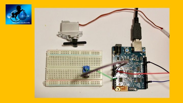

Step 2: Push Button Connections
1a
- The Black wire connects pin 1 of the switch (on the left hand side) to the GND pin on the Arduino.
- The Yellow wire connects pin 2 of the switch (on the right-hand side) to pin 8 on the Arduino.
- Connect a 10kΩ resistor -- brown-black-orange -- to pin 2 and the other terminal to the 3.3V pin on the Arduino.
Step 3: Servo Connections
2a
- The Blue wire is connected from the signal pin of the servo motor to pin 3 of the Arduino.
- The Red wire is connected from the signal pin of the servo motor to the 5V pin of the Arduino
- The Black wire is connected from the ground pin of the servo motor to the GND pin of the Arduino. Note that the switch is also connected here. so we can also connect it there on the breadboard, but the Arduino has multiple GNDs that are all common.

Step 5: It Moves!
Push the button and watch the servo move to a different angle each time.
