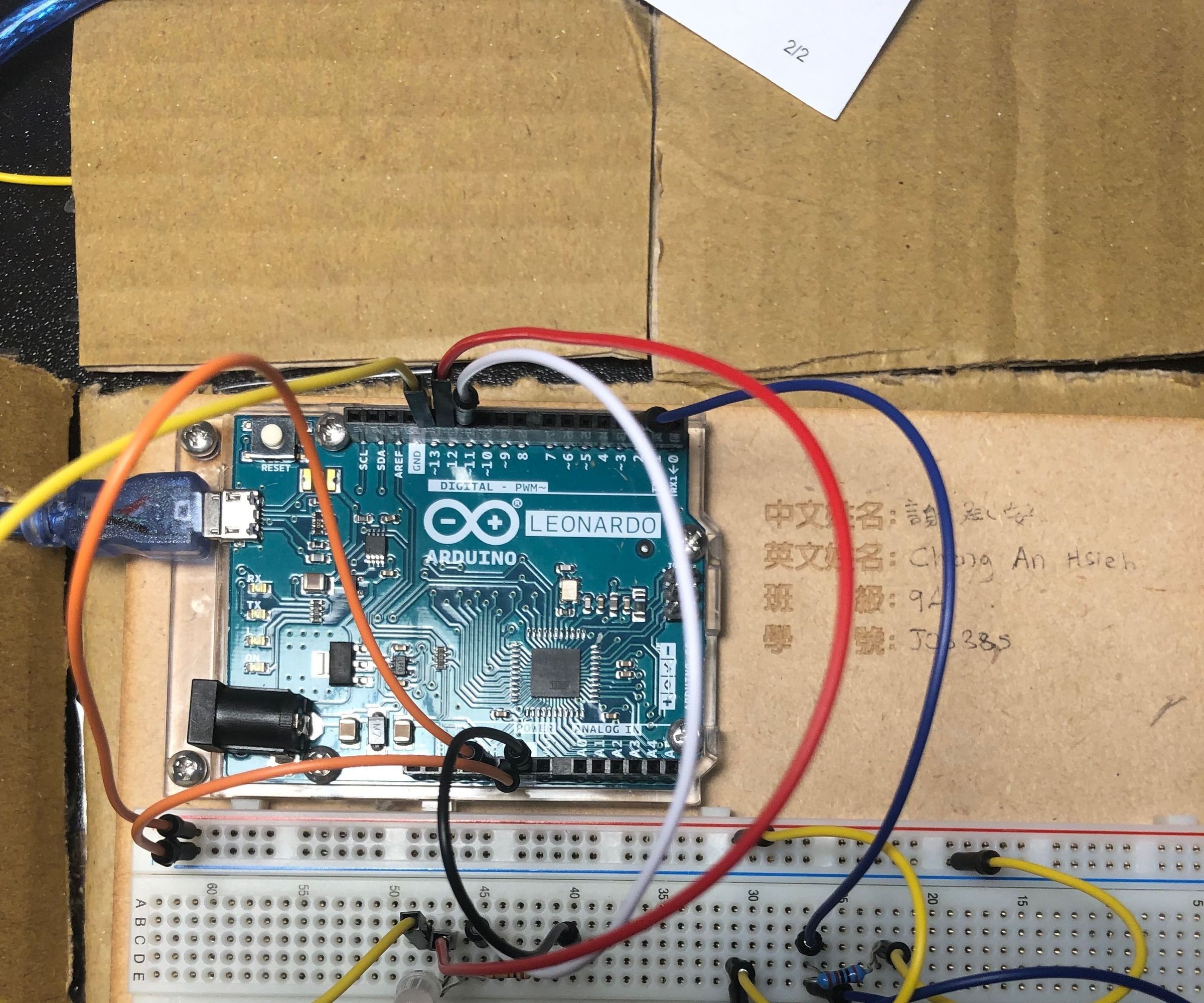

Step 4: Assembling the Circuit Board - Part 1 - LED Lights
This is the second part of this project. The LED Light parts. The circuit board might seem a bit messy and overwhelming, but it is actually very simple. The main thing you want is to connect the LED lights onto the circuit board as shown from above. You will want to use one 100 ohm resistors for each LED light.Somethings to keep in mind is that we will want to use male to female jumper wires to extend the LED lights since we want to install them onto the shield. Another thing to keep in mind is that connect the GND to the negative slot, not the positive slot. If you do so, it might cause damage to your Arduino circuit board.
Step 5: Assembling the Circuit Board - Part 2 - Push Button
This is the second part of assembling the circuit board. First we have already finish plugging all the LED lights and now we need to install a push button which will activate these LED lights. To let you guys understand how to assemble it easier, I separated the color of the wires from the LED lights and the button. For the button part, the jumper wires are yellow and for the LED lights, the jumper wires are green. For the push button, we will be needing a different type of resistor. The resistor is different from the ones for the LED lights. The resistor you will be needing is the 10k ohm.
