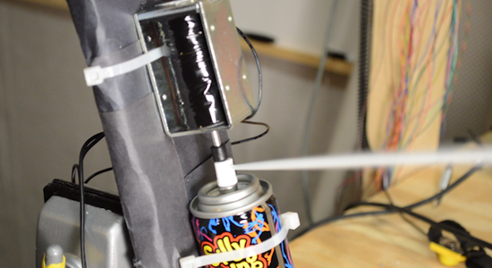

This Halloween a friend sent me this instructable and wanted me to modify the design and recreate it. I built a system that uses infrared sensors and infrared LEDs to detect when a hand is in the candy bowl, and use an Arduino to command a power switch tail which makes a solenoid trigger a can of silly string. To make connection of all the wires easy, I glued a terminal block onto a project enclosure and soldered short jumper wires to connect it to the Arduino. The Arduino was powered by a 9V battery and the solenoid and powerswitch tail were powered by wall AC power.

I started off the build by soldering wires and resistors to the IR LED and sensor. They were also glued onto a plastic pumpkin. Next I mounted a solenoid and silly string can to a few pieces of foamcore. I then cut a hole for the terminal block and glued it in place. After that was done, I soldered header wires to the terminal block and connected the header wires to the Arduino. Finally I placed everything where I wanted it outside, and this project was ready to go.
