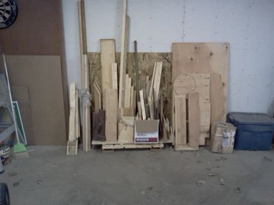

Since I wanted to minimize the difficulty while keeping the price low it was a balance between buying as little as possible while not making it too hard to construct. the hardest thing to find locally will be the fretwire, I found mine at a store which also did some repair work. It's easy to find online though if you're willing to wait.

- 1x 2x4 to make the neck
-1x cedar fence board (for the fretboard (something harder like maple would have been better), to add some colour to the neck, and to reinforce the box/neck joint)
-2x10 or similar (optional: to make a new top for the ukulele, you'll need a board as wide as your box or you'll have to glue pieces together)

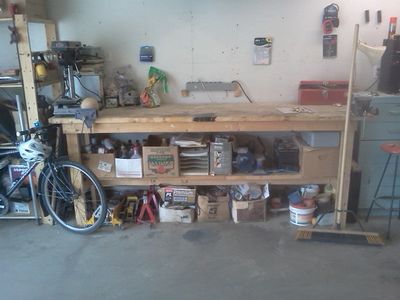

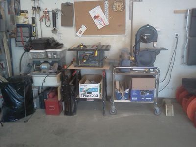

I ended up using a lot of tools in this project which everyone might not have. I'll suggest some alternatives here that could be used instead
-Drill press (a regular drill could be substituted easily)
-table saw (there's no dado's or anything fancy so a simple hand saw could be used in a pinch)
-thickness planer (for everything besides making a new top it's not necessary, a block plane could be used, or sandpaper on a block)
-band saw (a hand saw and files/sandpaper could get the same result, it will just take longer)
-belt sander (files/sandpaper could be used)
-thin kerf hand saw for fretting (can be found for <$10 at a hobby shop, I used a razor saw)
-digital caliper for marking frets (a ruler could be used in a pinch)
-square to mark frets (many things can be used as an improvised square, or you could make your own)

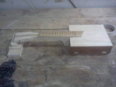

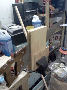

I also used a piece of 2x10 to replace the plywood bottom of the box with solid wood. I used a handsaw to cut the 2x10 into roughly thirds then ran the best piece through the thickness planer until it was ~3mm thick. I used a chisel to take the bottom off the cigar box and glued the new top on. I also glued in some ~1cmx1cm supports around the outside so there would be more glue surface. I marked where I wanted the sound hole to go then drilled it with the biggest drillbit I had which was ~2" diameter. I drilled it using a drillpress and put some scrap 2x4's under the top so it was supported well and to minimize tearout.
neither of these are necessary, but the new top is a nice touch to make it sound better.

The first step for assembly is to drill the hole for the bolt that will attach the neck to the body. I drilled mine a bit above the center of the heel so there was a bit more wood. again i would suggest drilling a couple test holes to see what size works best for the threaded insert you bought. too small and you might crack the neck, too big and you'll have to glue the insert in.
Next is to drill the hole for the bolt in the body. mark where it goes so that when the neck is bolted up the top of the neck and the body are flush. you want the hole to be big enough for the bolt to slide in easily and not stick. the hole should go through the wall of the box and the piece of board you glued in (if you added one). once the threaded insert is in the neck you can bolt the neck and body together. be careful to make sure the top of the neck isn't twisted relative to the top of the body once it's all tight.
now you can glue the fretboard to the neck. I waited to do this since using only one bolt the neck/body twist a bit while tightening, if you're not careful and have the fretboard attached while you're tightening it you can break or warp the fretboard. you can use some cut off nails in the neck and some little holes on the bottom of the fretboard to make sure they stay lined up while glueing. use something soft like a 2x4 over the fretboard if you clamp it down otherwise you might wreck your fretjob. I just taped it down with some masking tape and put some weights on it.
once I had the ukulele assembled I finished it with some watco medium walnut danish oil, but you could use whatever you wanted, even paint!
