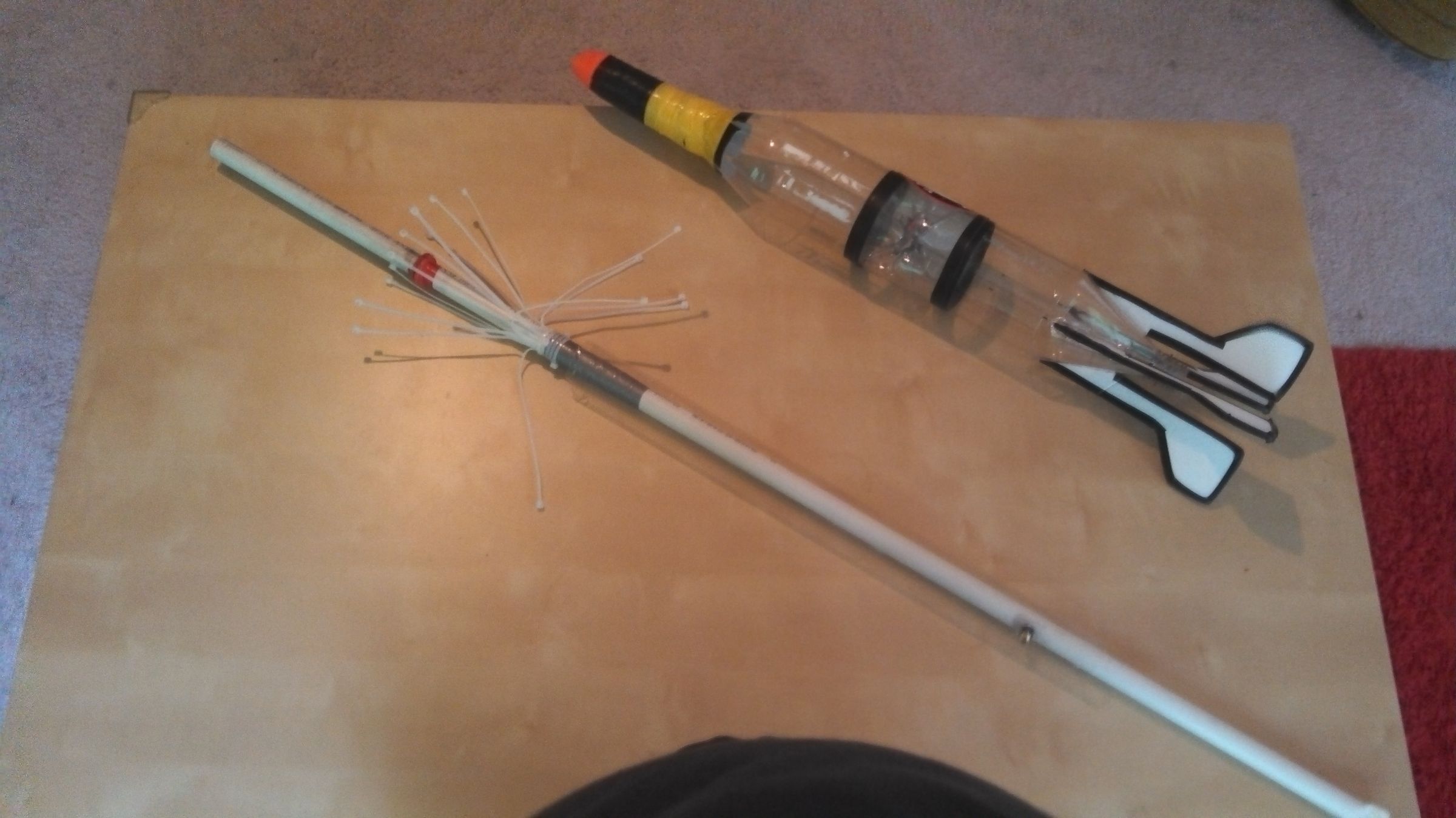

Introduction: Simple Combustion Launcher
This combustion launcher design is a refinement of nighthawkinlights design.
I use a stun gun for ignition instead of a piezoelectric ignitor, guarantees a hot spark and facilitates separation of the launcher from the operator adding safety.
I'm able to launch plastic bottles over 100 metres with this device.
launch procedure is
spray fuel in bottle
place bottle on launch tube
connect ignitor.
FIRE
created painfully with instructables for android
launch procedure is
connect ignitor.
FIRE

Step 3: The Assembled Launcher
This is hot the launcher appears assembled sans blast shield
Step 4: Ignition Tube Assembly
Insert the wire with the crumpled paper at the end of the PVC.
Inject a sizeable amount of hot glue at the end. This forms a seal. See the photos for additional information.
