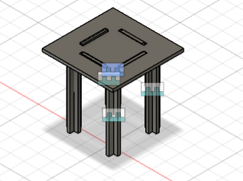

Step 6: Create Fusion Design
Creating my fusion designed chair was a process of making all of the pieces and then putting them together. I created all 4 legs and the top and then once I had done that, I placed joints to join my stool together. I then realized that the measurements for the top of the stool were slightly off so I had to go back and adjust them by a couple millimeters and check to see that it now fit. The top then fit the second time.

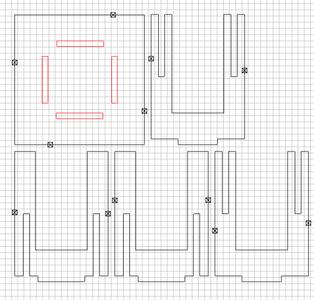

Step 7: Carbide Create
I then used the arrange tool to lay my chair's pieces out flat in fusion so it could be imported into Carbide Create. I imported the file to carbide create and created toolpaths and placed tabs. I uploaded this Carbide Create file onto the USB that attached to the computer connected to the CNC Machine.
Step 8: Cut Out Small Scale Chair
I went to cut out my chair and realized I hadn't changed the size of the pieces of wood for my chair to be printed on. Therefore Carbide Create was recognizing my chair as if it was on a bigger piece of wood, so it started to cut incorrectly.
Step 9: Troubleshoot
I went back into Carbide Create and changed the size of the wood for the chair to be printed on, so it would print correctly.
