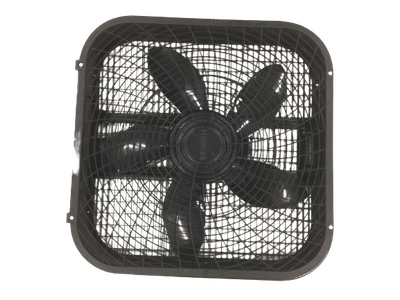

Step 1: Get Measurements From Your Box Fan
Most box fans have a cap which you turn to control the speed of the fan. Take off this cap to reveal the inside part that latches on to the cap. Using the caliper get measurements of the knob part underneath the cap because soon we will make a custom cap in CAD that we will fit on the fan which will allow the EV3 to control the speed of the fan.

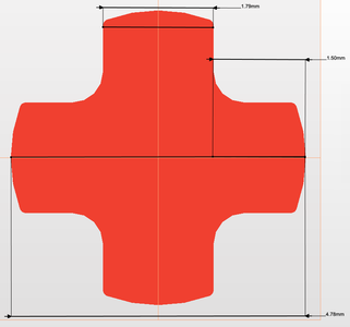

Step 2: Get Measurements of the Lego Axle
Using the caliper, measure the face of the Lego Axle. You will need this for creating the custom Cap in CAD for the fan.

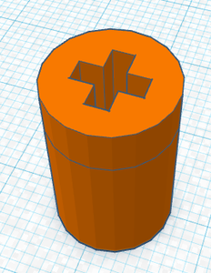

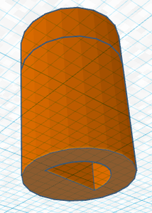

Step 3: Create Custom Cap in CAD
For this step I am going to use tinkercad, however you could use any 3d modeling software. First, start off by making a cylinder. The diameter of the face of the cylinder should be big enough to fit the cutout that that can house the inside knob of the fan. Next, make a hole at the bottom of the cylinder that matches the shape of the knob sticking out of the fan. Then, make an axle cutout at the top of the cylinder that will house an axle connected to an EV3 motor. Remember to add some wiggle room because the printer won't print 100% accurate to the dimensions you give it.

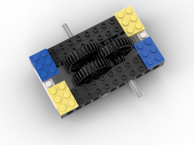

Step 5: Create Lego Gearbox to House on Fan
Since the knob on a box fan is meant to be turned by humans, it takes quite a bit of force to turn it. Because of this we have to add a gearbox to the motor since the motor is not strong enough by itself. I have attached some pictures as to how I put together my gearbox. As every fan is different you may need to tweak the gearbox to make it more or less strong. Make the gearbox by adding cascades of bevel gears to a frame. Add velcro to the geared down facing side so that we can later stick the gearbox to the fan.

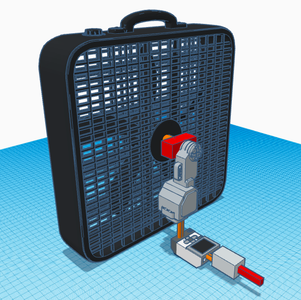

Step 7: Put It All Together
  1. Attach the 3D-printed cap onto geared down end of the gearbox.
  2. Velcro the gearbox onto the fan so that the 3D-printed cap attaches to the fan.
  3. Connect your EV3 motor to the other end of the gearbox. Secure the motor to the fan with Lego pieces and velcro.
  4. Plug the motor and the temperature sensor into your EV3 brick.
  5. Connect power to your fan and to your EV3 brick
  6. Start the code and make sure everything works fine
  7. Voila! You know have a more effective and efficient fan to help keep you cool!
