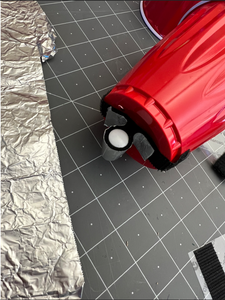

Step 13: Putting White Nub in the Velcro
Take off the white end from the doorstop and put it in the loop

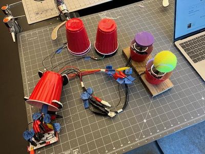

Using velcro attach the makey makey inside of another solo cup. Then you need a lot more wires. Four ground, one for each component. Make sure the ground for each component if possible is a different color this will be helpful later. Four more for each joystick. And one more for both of the buttons. Cut a large hole in the bottom of a solo cup and feed the wires through it. It is highly recommended to label each of these wires as it makes setup much easier. One side of the wires will all connect to the makey makey and the other wide will connect to all your components.
Step 38: How to Make Unique Wire
The wires for the joysticks (if you want certain functionalities) need to look like this in order to connect to the makey makey. Take one wire a cut it into small sections. Then strip both sides. Wrap one aside around the end of the alligator clip and wrap it in electrical tape. The side with the exposed wire goes into the makey makey.
Step 39: Final Product
This should be how it is wired up.
