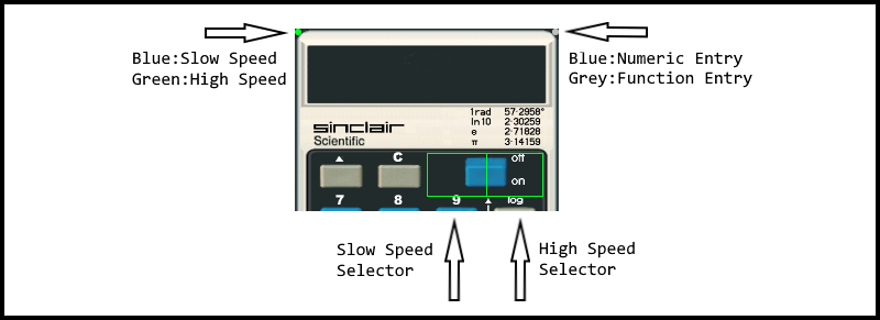

Step 6: Using the Simulator
  • Touch the left side of the "Power Switch" to run the simulator in slow speed.(Default mode) Blue dot at the top left corner of the screen is indicating the slow speed. All calculation steps are visible in this mode.
  • Touch the right side of the "Power Switch" to run the simulator in full speed which is compatible with the real hardware. Green dot at the top left corner of the screen indicates the full speed.
    Calculation steps are not visible in this mode. Splitting of the Power Switch area seems odd but compatible with the remaining of the keypad.
  • Blue dot on the top right corner indicates that numeric entry is accepted.
  • Grey dot on the top right corner indicates that function entry is accepted and calculation is in progress.
  • If SD Card is not inserted, LCD will display red color in full screen.
  • If "CalFace0.bmp" file is not present on the SD Card, LCD will display blue color in full screen.
