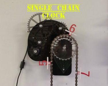

I have always had a fascination with clocks, The constant movement, the timing, and the art. It is beautiful. It has always been my way of integrating Technology and art. My first instructible was a wooden chain clock. I had so much fun making it that I have thought of several different improvements that I can make to create a completely new clock.
This clock Incorporates a single movement on the hour hand that also shows the minute by showing the minutes as a gauge. I chose to use acrylic and a metal chain for this project as I thought that using the metal bicycle chain complimented the look of the black acrylic.
I really enjoyed making this and I hope you will as well.

Step 3: Glue the Numbers Together
Before I mount the numbers on the chain I will peel the film off of the numbers. Acrylic has a film coating that keeps it from getting scratched. So after the film is peeled off then I glue the White arrows onto each of the numbers. I do have some acrylic weld that I thought about using to put the arrows on the numbers with, but I decided to use regular super glue instead. It seems to work great so long as you do not use too much.
Step 4: Assemble the Chain
So because I am starting with a whole unbroken chain, I need to use the chain break tool to break the chain at certain intervals so that I can insert the numbers. The way that I designed the clock there is a hour every 12 links. So the chain links need to be 11 links long.
It took about 1 1/2 chains to get the 12 sections of chain that I needed to complete the clock. Now that I have the sections of chain cut I can start to put it together. I started at the number 1 and bolted it on. I used the m3 x 12 hex head bolt from the parts list in step 2. So it seems to work best when I included a washer on either side of the numbers. So just to clarify, if looking from the top is is chain, washer, acrylic number, washer, chain. LOL That is confusing. Just look at the pictures, I have faith that you will figure that out.
So putting the chain together is by far the most time consuming part of this build. As I am putting the chain together I think "isnt this why I have Children?". So in the future, the kids are putting the chains together for me. I will call it "family togetherness time" or "lets play Malaysian sweatshop". I forsee that lasting about 5 minutes before "dad this is boring", dang kids these days.

Step 10: Assemble the Clock
The Frame is pretty easy to assemble, everything gets bolted onto the main base and then the back will go on last.
Start with the m6 x 30 bolts and put them through the three gear holes towords the top, and put a washer and then double nut them all. The main shaft that the chain will be on uses a m6 x 50mm bolt and will also be washered and double nutted (is that a word?). Then you can put another washer and then the gears, then another washer and then the lock nut. Do not over tighten the lock nut or the gears will not move.
The stepper motor is mounted with 4 M3 x 8mm bolts. Then the Main Gear needs to be assembled, it is the large toothed gear, then 3 spacers, and then the spur gear, Held together by 2 M3 x 30mm bolts with lock nuts on the back.
The Minute guage gets attatched using 2 M3 x 16mm bolts and nuts held in to place. Then the only thing left is to hang the chain and plug it in.
Step 11: Finishing Touches
The chain ended up weighing a lot, so I added a small piece of wood to the bottom of the frame so it would sit straight on the wall.
Pick your colors carefully, trust me. I made another chain in red, because it turns out that black numbers over black gears, and a black frame, is not so readable (who would have thought???).
I made several clocks and several chains, they look completely different with the different color chains.
