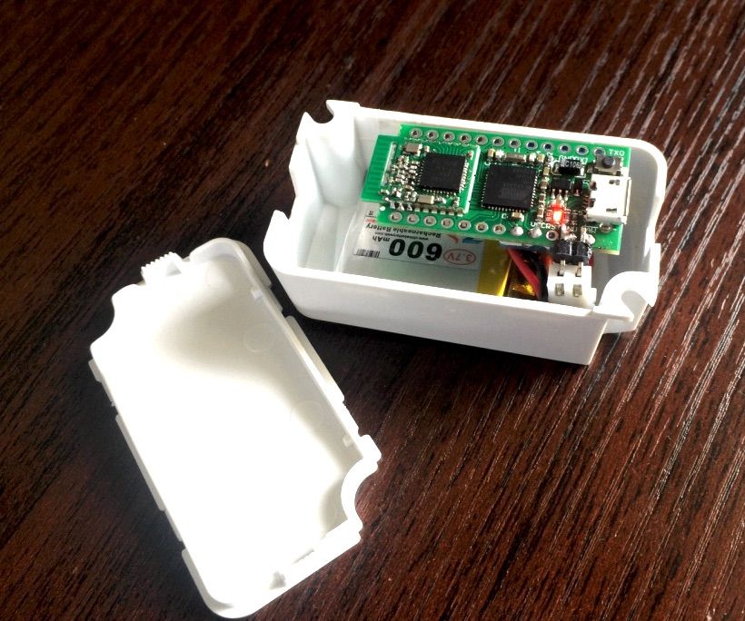

- ESPea - Mini ESP8266 Dev Kit.
- Relay Shield for ESPea - an add-on board that allows your ESPea to control higher voltage and current loads through a relays.

The Relay Shield is a stackable shield for ESPea. It wires relay pin to ESPea D1 pin default.
- Stack the Relay Shield to ESPea board. Let the micro usb cable to outside so you can programing it easier
- Wire DC 12V+ to lock's red line.
- Wire lock's black line to the middle port of relay
- Wire DC 12V- to relay's NC port
Note: The ESPea need 5V DC to drive the relay. So you need keep plugging the micro usb cable.
