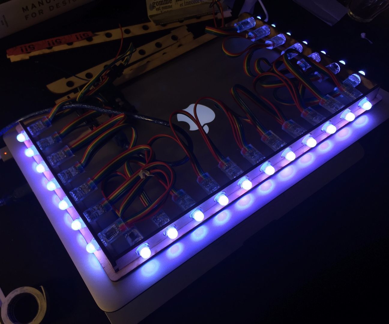

Step 4: Circuit
For the 4th lesson we had to lookup some information about the circuit, which is one of the requirements for our design. I'm going to use two RGB led strips of 40cm, these will be attached at the back of the skateboard. See the pictures for an overview of the led circuit and the led strips I ordered. Working on a new design to attach the led strips to the skateboard holder, so keep tuned in!

So I made this new design because the old design included a lot of bolts, so I wanted to scale that down! After I made a few adjustments to the previous Solidwork 3D CAD design, it was time to print it! I used an UP 3D printer at my school at Academieplein. The print was done after 2 hours. It fits perfectly in the holes of different kind of skateboards, so the sizes are good this time! Oh, and I also addes some RGB LED strips, just because it looks cool :)
