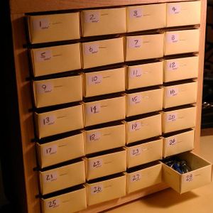

Introduction: Small Parts Cabinet
In this instructable I'll show you how to make a 28 drawer small parts cabinet for your workshop that you can use to hold small fasteners, electronic parts, etc. [1] The design features drawers that can be made from various weights of 8-1/2 x 11" paper stock (and potentially other materials). The total cost for a fully populated cabinet should be around $10 - $15.
I'll assume that you already possess some basic woodworking skills (like the ability to accurately cut materials to size, make good square cuts, etc.).
Thanks for considering a build of this instructable. Be sure to leave feedback in the comments. ;-)
Features
  • is sturdy
  • is stackable
  • has non-skid feet
  • is inexpensive
  • is sized to accommodate 28 drawers (when drawers are made per the included instructions) while at the same time minimizing the need for any additional shelf support (though such could be added if needed)
  • drawers can be made from one or more (depending on strength desired) 8-1/2" x 11" sheets of... printer paper, heavy card stock, poster board, thin cardboard and conceivably even plastic (cut from 2-liter soda bottles) or thin sheet tin (thus far I have only constructed drawers from paper based materials myself)
  • unlike with parts cabinets bought at home improvement stores, the drawers for this cabinet are replaceable if they become damaged (you only need to keep a few unfolded drawers or "blanks" on-hand for when the need arises to replace a drawer)

Step 1: Cut the Cabinet Top and Bottom Boards
The first order of business is to cut the cabinet's top and bottom boards from the one piece of 1 x 6 lumber. These two boards each measure 13-1/2" long.
Step 2: Cut the Cabinet Side Boards
Next, You'll need to cut the two side boards to length. These should be cut to a length of 12-1/2". On these, be especially careful that the cuts are straight and consistent. Recall from the earlier plan drawing that these side boards will butt into the top and bottom boards and therefore, a poor cut here could end up being visible when viewing the cabinet from the side.
Step 3: Mark the Desired Orientation of the Side Boards
Now that all of the cabinet boards have been cut, mark each side board near its bottom edge with a down-pointing arrow. This identifies not only the face of the board that will later receive the dado cuts, but also the board's orientation with respect to gravity (in other words, we want the dado cuts to be measured from the same end of the board and this marking makes that possible).
Step 4: Mark Dado Cuts in Cabinet Sides
In this step the dado cuts are marked on either one or both of the two side boards in preparation for cutting. Whether you need to mark both boards depends on the actual method you'll use to make the cuts. Most likely you'll need to mark only one of the boards and then each dado cut will be made to both boards before setting up the next dado cut.
Marking the boards can be done in various ways. One is to use your calculator and apply the following formula:
shelf distance = shelf no. x 1-13/16"
Here, shelf distance is the distance from the bottom of the side board (the end with the drawn arrow) to the top of the shelf and shelf no. is the number of the shelf (1 - 6) where the lowest shelf is shelf number 1. Therefore, the dado cuts can be marked according to the following table (where the first column is the shelf no. and the second is the shelf distance):
  1. | 1-13/16
  2. | 3-5/8
  3. | 5-7/16
  4. | 7-1/4
  5. | 9-1/16
  6. | 10-7/8
A more clever method of marking the dado cuts is to make use of a couple of offset jigs. Such a jig is nothing more than a piece of scrap 1 x 2 cut to exactly 1-13/16". As you may recall from the plan drawing, this offset represents the distance from the top of a shelf (including the bottom cabinet board) to the top of the next higher shelf. Applying the first jig is a matter of aligning the edge of the side board having the arrow marking on it with the edge of the jig itself. To do this, simply butt the edge of the side board and the edge of the jig against another board that has been clamped to your workbench. Once aligned in this fashion, the opposite edge of the jig should be 1-13/16" from the edge of the side board and will thus represent the first shelf's "shelf distance". Mark it with a pencil. Now, while firmly holding the offset jig in-place, position the second jig adjacent to the first and again, mark the location (for the second dado). To mark the third dado, simply "leapfrog" the second jig with the first one and mark... Repeat this leapfrogging until all the dados are thus marked.
Note that each marking made on the side boards according to the above instructions represents the top of a shelf. As such, be sure not to accidentally cut on the wrong side of this mark. It can be helpful to draw a small "x" on the side of the mark representing where the cut is to be made.
Step 5: Perform a Quality Check
After you've marked the side boards using whatever method, you may want to perform a quality check before proceeding. There's nothing worse than ruining a work piece for lack of a simple quality check.
Presumably, you've marked the dado cuts across the face of the side boards. If you subtract the thickness of the dado from the first shelf mark, the distance from the left edge of the board to this new marking should equal the distance of the last shelf mark from the right edge of the board (see photos). If the two distances are significantly different, you may need to re-mark the board before proceeding.
Step 6: Route the Dado Cuts
In this step, you'll make the dado cuts in the two side boards. Each dado cut is 3/16" wide and 3/16" deep.
Most persons following this tutorial will likely use a router to make these cuts. I would have chosen this same approach myself had my router not been DOA at the beginning of this project. As a result, I was stuck with having to cut the dados using my table saw... and without a sled.
As you can tell from the photos, I opted to mark my side boards so that I could make three dado cuts, flip the board around and then make the other three from the other side of the board.
Being as I was not using a dado blade, I had to do two cuts per dado. This I did by using a 1/8" thick metal ruler to "offset" the cut. Typically, I'd make a cut, add or remove the ruler and then make the second cut. The method wasn't quite as simple as using a router, but it worked out ok.
Step 7: Assemble the Frame
Assembly of the frame is pretty straight-forward. Taking into account the preferred orientation of the boards which you should have decided previously, simply line up any two adjacent sides, drill two pilot holes sized appropriately for the screws being used and then drive the two screws.
My situation required a little more attention given that my choice of lumber was less than ideal. Because my boards exhibited some "cupping", I found it necessary to pre-attach the adjacent sides using C-clamps and a short length of 2 x 2 and then, once everything was perfectly lined up, I could then drill the pilot holes and drive the screws. This greatly minimized the effects that cupping would have otherwise had.
Be sure your pilot bit is sized properly to maximize grip -- especially if you're dealing with warped lumber that needs "correcting". For a little extra grip, I didn't drill my pilots quite as deep as the length of the screws, forcing them to grip that much harder during final tightening. BTW, to avoid breaking screws, don't use your hand drill to drive them all the way to depth. Instead, "seat" them using a regular screwdriver.
Step 8: Add the Cabinet's Backboard
The backboard is cut from the 3/16" MDF/hardboard. You can use the completed cabinet frame itself to trace the dimensions onto the backboard for cutting; however, you might want to size each dimension about 1/8" short in order to prevent the backboard from potentially getting caught on something and separated from the frame.
Note from the photo that I chose to use pegboard for my cabinet's backboard. I chose pegboard simply because I had an ample supply of it in my shop and plus, I wanted to preserve the thicker 3/16" hardboard to use as shelves on later built cabinets.
Once you have cut the backboard to size, simply nail it to the frame using the 1/2" brad nails.
Step 9: Add the Cabinet Feet
No cabinet is complete without feet. Depending on the kind you purchase, they may attach via included wood screws or by some form of adhesive. Simply locate the feet so that they're sufficiently near each corner without interfering with the existing wood screws that attach the cabinet sides.
Step 10: Cut and Add the Shelves
Next, you'll need to cut the six shelves from the hardboard/MDF. These are probably best cut on a table saw. Each shelf's dimensions are 12-1/4" x 5-1/2".
