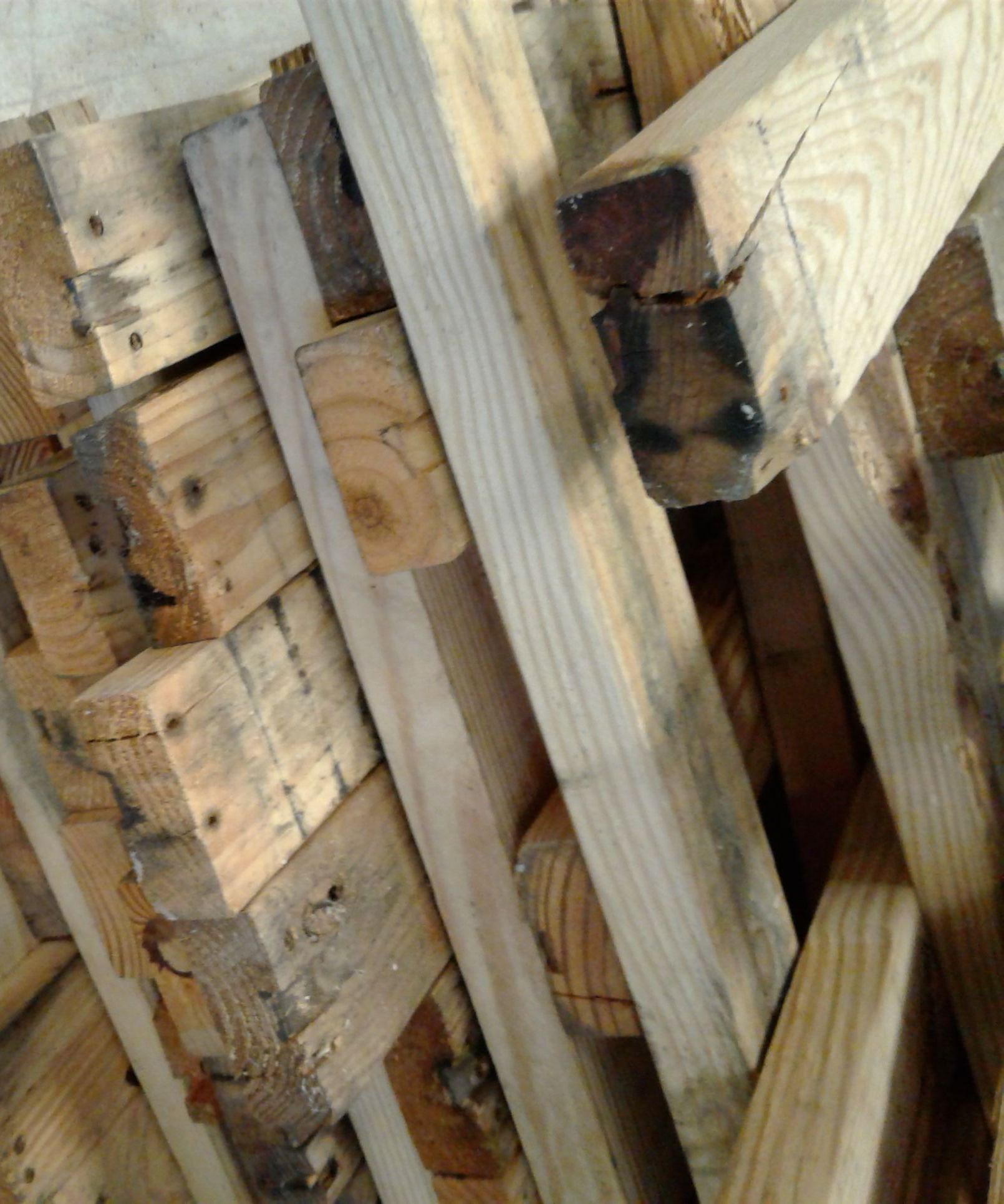

I build a side table out of 2x4" pallet wood.
Step 1: Step 1: Materials
Gather some 2x4" pallets and cut four 20" inch boards.
Cut two 7" long braces and two 11" long braces.
