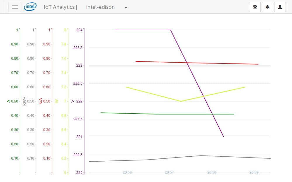

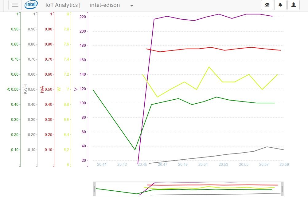

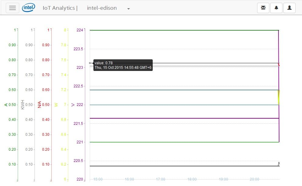

Send all the data to cloud and graphically show those by different charts & graphs.

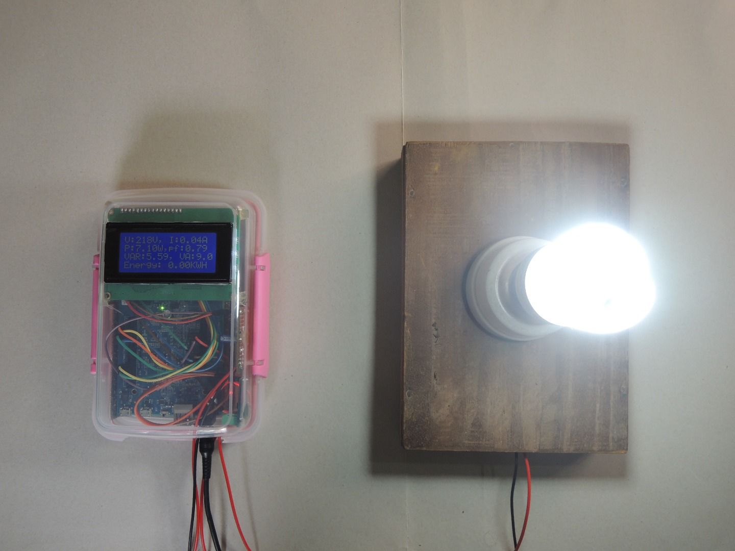

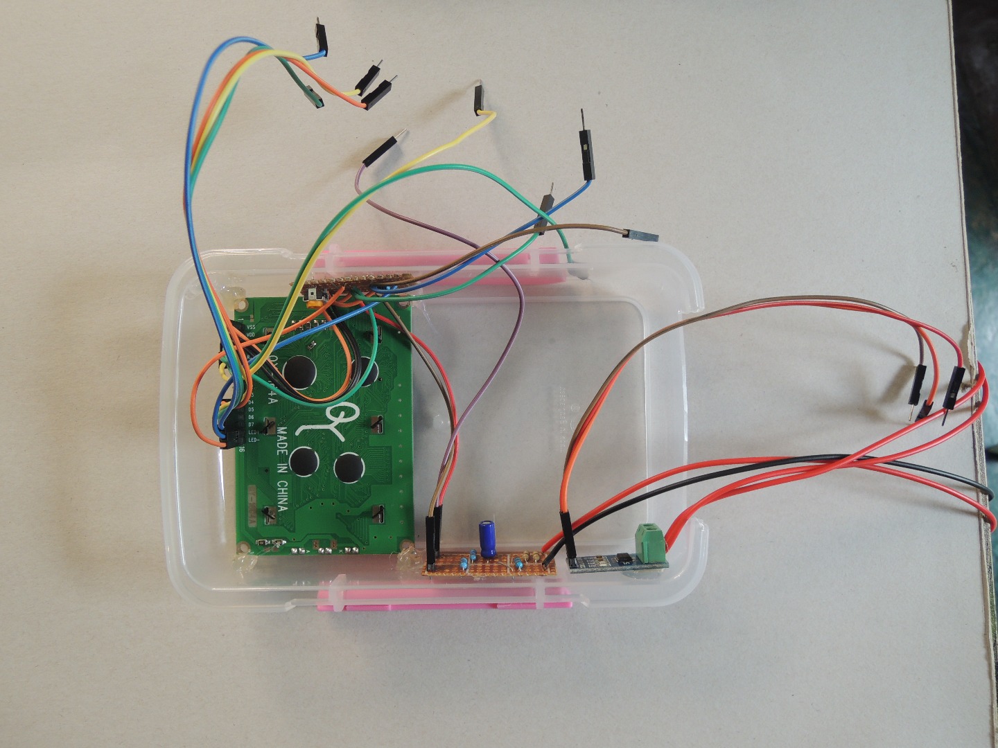

I connected a LCD display to Edison for showing the data. The system also sends real time data to cloud server and you can monitor your data from anywhere of the world. Intel Edison is the center of the system. Current sensor & AC/AC adapter is used for sensing current and voltage.

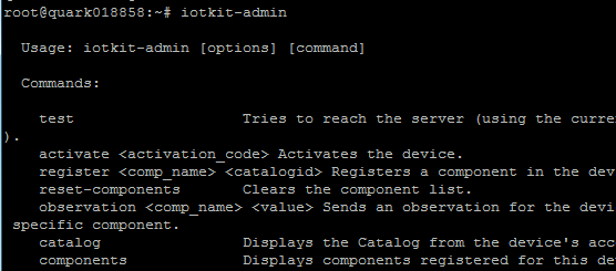

iotkit-admin
If you see a message that begins with, “Usage: iotkit-admin …”, as shown below, the agent is already installed.
To test network connectivity, enter the following command:
iotkit-admin test
Address any connection problems and repeat the test command as necessary to ensure that your device can connect to the IoT Analytics site. You should see the following message:

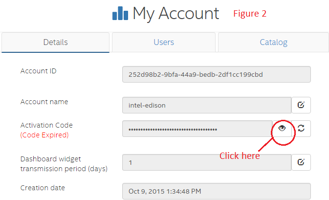

Step 6: Adding Device to IoT Analytics Dashboard
Before connecting Edison to the cloud, but it needs to be registered on Intel's Analytics Dashboard. Registering the device opens a channel of communication between it and your cloud account. Follow the steps to register your device.

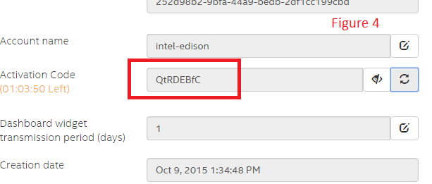

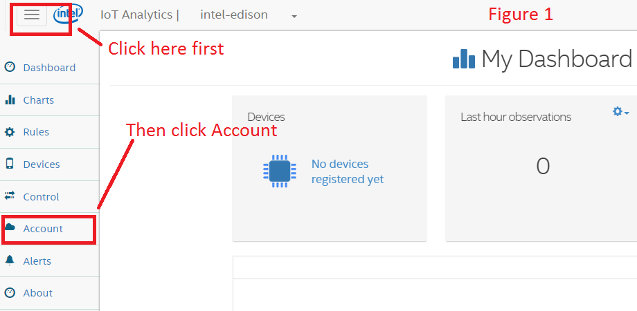

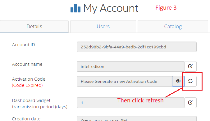

1. After log in to the IoT Analytics site, click the menu icon in the top left. Select Account.(Figure 1)
2. On the Details tab, locate the activation code, which is displayed in the Activation Code field. To you see some dot then click the eye icon to display the code. (Figure 2)
3. If code is expired, click the refresh icon. code will be displayed. The activation code is valid for 60 minutes. If the code expires before you have activated your device, click the refresh icon to generate another code again. (Figure 3)
4. Note the Activation Code (Figure 4)

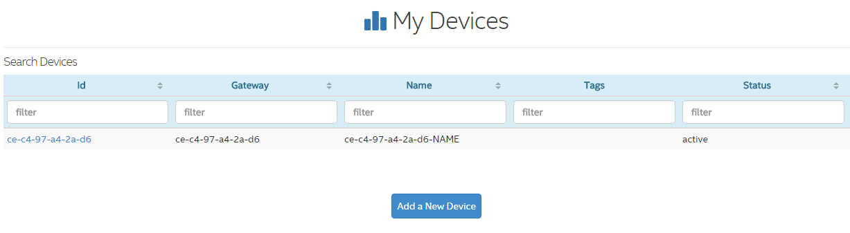

4. In the serial communication window, enter the following command:
iotkit-admin activate ACTIVATION_CODE
Paste the activation code where ACTIVATION_CODE is written.Your device is associated with the account that the activation code was generated and you will get following message.

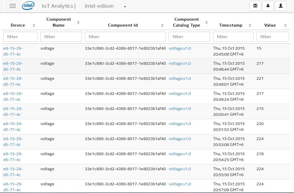

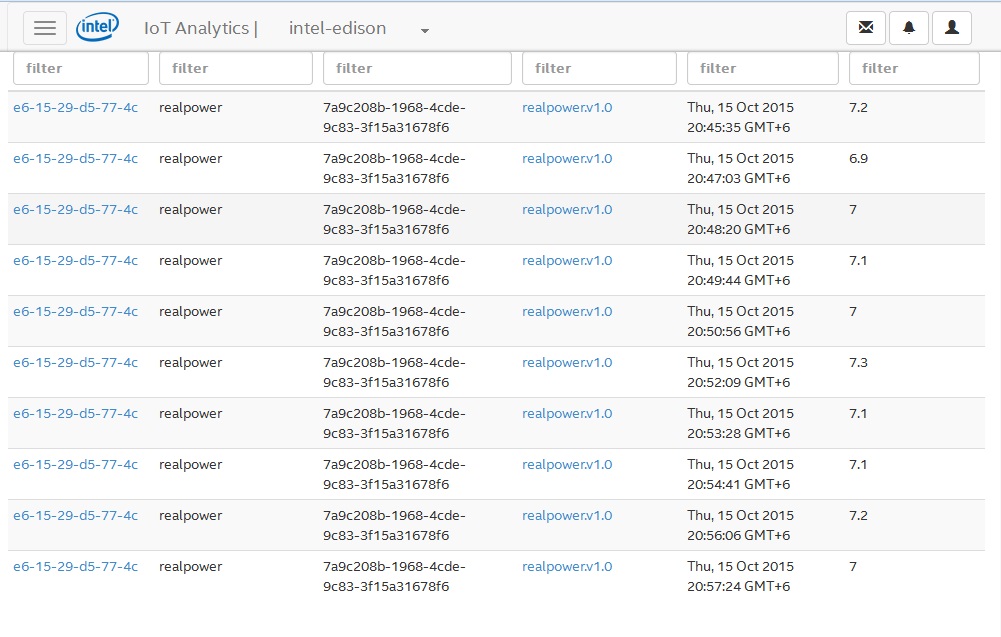

Now, you can verify this on your IoT Dashboard in the Devices box.
Our device is now registered. Once the device is registered, sensor data from that device is sent to the IoT dashboard. However, to obtain data from a sensor you must first create a catalog item for it. The IoT Dashboard calls catalog items "components", and there is a component for each sensor (or may be for each data item) connected to your IoT device. This enables your Dashboard to grab real-time data from your device. Our next step is to create component.

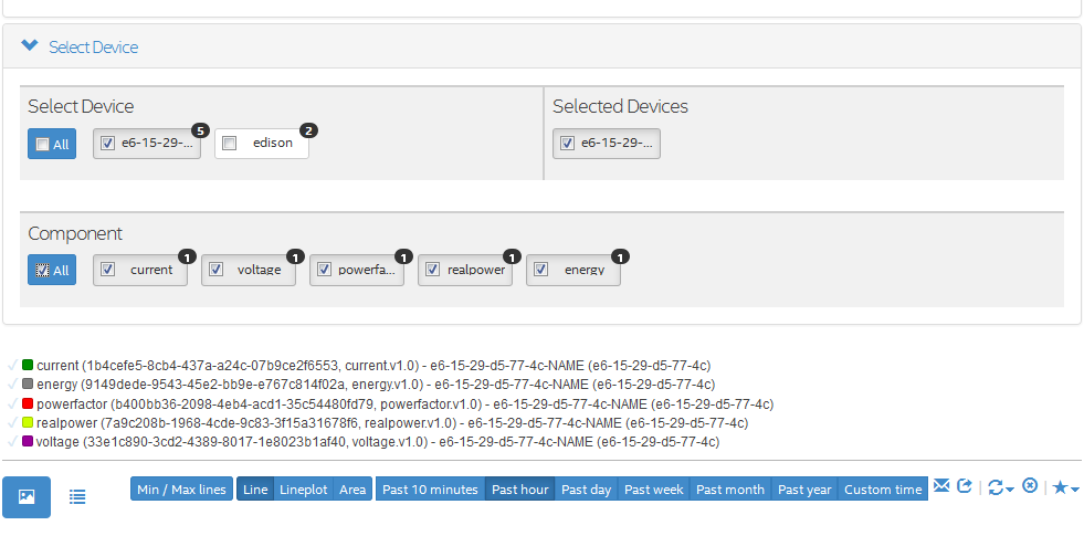

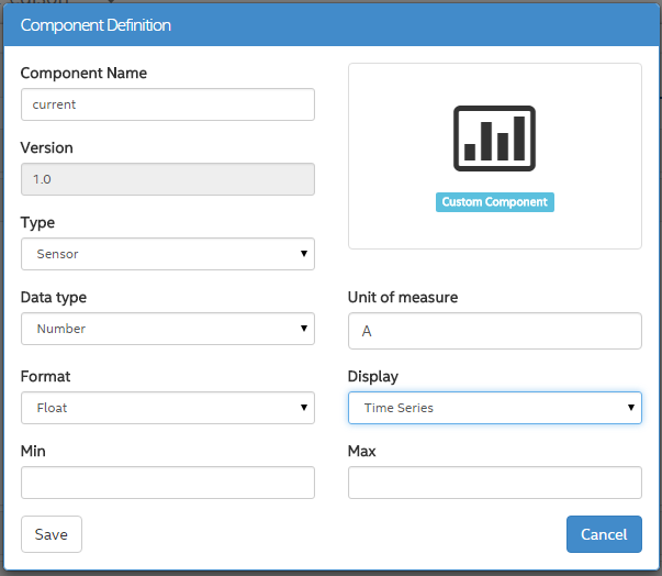

Creating Component

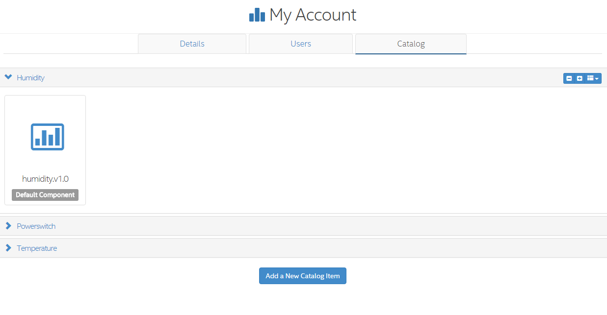

1. Access the Component Catalog by clicking on Catalog tab on the Account page. Your account comes with three default components: humidity, power, and temperature. A component can be either a sensor or an actuator. To add a new component, click Add a New Catalog Item at the bottom of the screen.
2. A Component Definition box appears. Add and save relevant information about your sensor in the Definition Box shown in the following figure. This current component will receive current from the current sensor.
2. Following the same procedure create four more component named as voltage, realpower, reactivepower, powerfactor and energy as we want to sent all the parameter to the cloud from Edison.

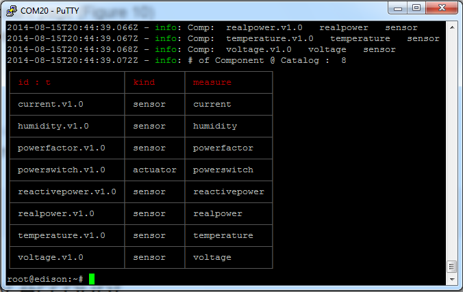

After creating a component in the Dashboard, you need to register it on your device. To register your component enter the following command:
iotkit-admin register component_name component_id
Component name and type can be found in terminal by the following command
iotkit-admin catalog
After typing the command view of terminal window.
From the figure it is clear that our first component is current an id is current.v1.0
For registering current component type:
iotkit-admin register current current.v1.0
You may need to restart the agent before you can register a component. Enter the following commands to restart the agent:
systemctl stop iotkit-agent<br>systemctl start iotkit-agent
After successful registration you should see following message.
Congratulation! your registration is complete.

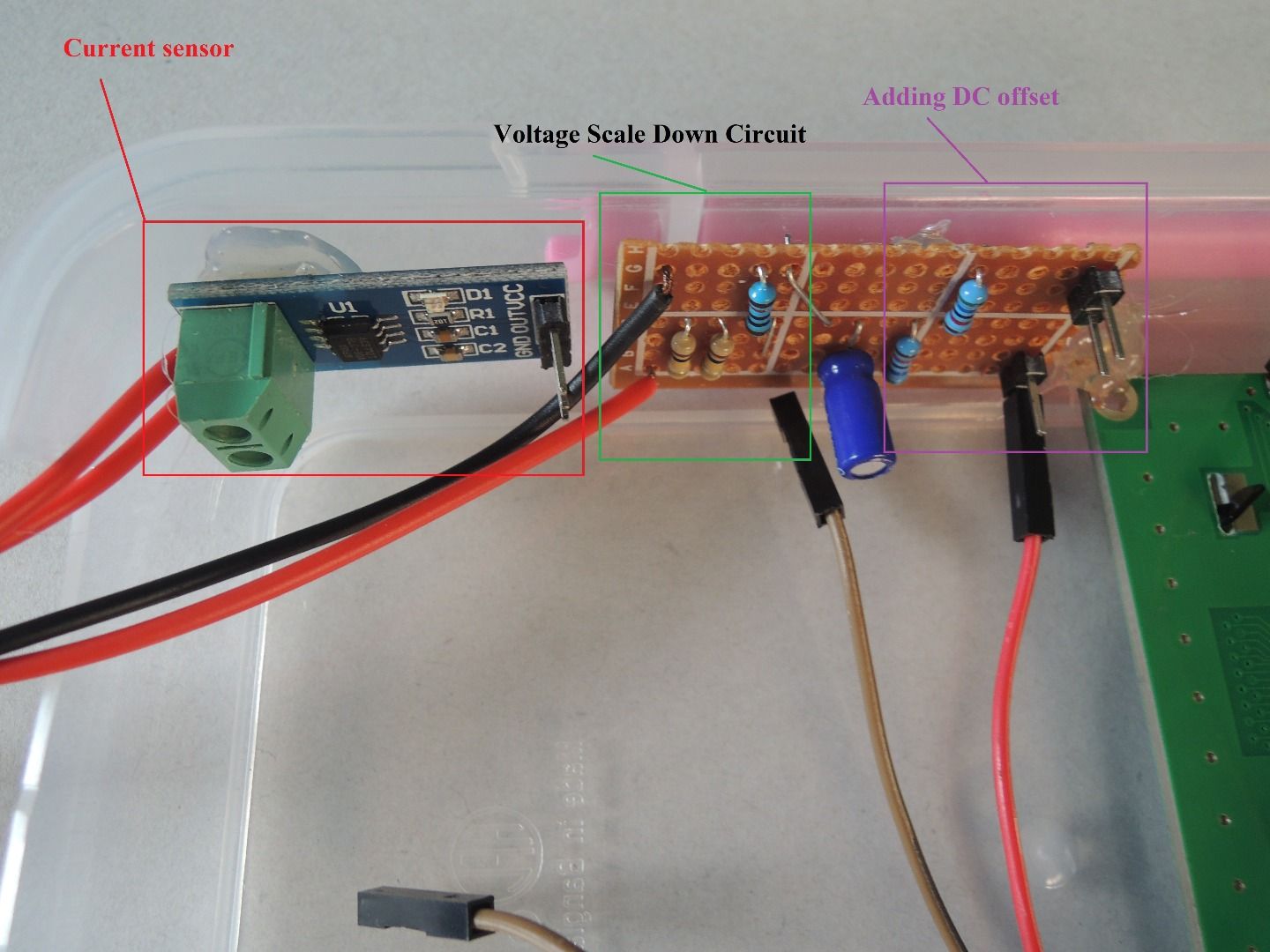

Step 7: Makeing the Circuit

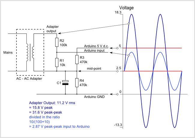

For the power and energy calculation we need two parameter. Supply voltage and load current. Our utility supply is 220V AC and enough for an electric shock. The measurement can be made safely (requiring no high voltage work) by using an AC to AC power adaptor or transformer. The transformer provides isolation between the high and low AC voltage.

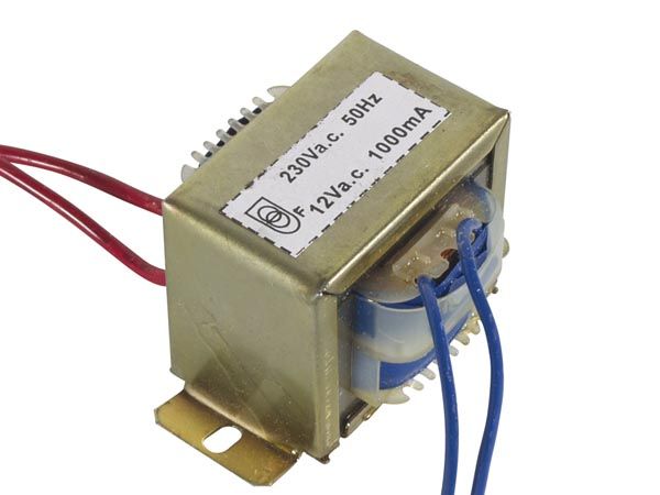

Voltage Sensor (AC/AC transformer)
AC to AC power adapters or transformer can come in many different voltage ratings. The first thing that is important to know is the voltage rating of your adapter. I have used a 220V to 12V transformer for voltage measuring.
The output signal from the transformer is a near-sinusoidal waveform. If you have a 12V (RMS) power adapter the positive signal peak should occur at +16.97V and the negative signal peak should occur at -16.97V. However due to the poor voltage regulation with this type of adapter when the adapter is un-loaded (as in this case) the output is often around 14V-16V (RMS) giving a peak voltage of around 19V-23V. The voltage output of the transformer is proportional to the AC input voltage.
The signal conditioning electronics (Arduino, Edison) needs to convert the output of the adapter to a waveform that has a positive peak that's less than 5V and a negative peak that is more than 0V and so we need to
  • 1) scale down the waveform and
  • 2) add an offset so that there is no negative component.
The waveform can be scaled down using a voltage divider connected across the adapters terminals and the offset (bias) can be added using a voltage source created by another voltage divider connected across the Arduino's supply shown in following figure.
Resistors R2 and R1 form the voltage divider that scales down the power adapter AC voltage and resistors R3 and R4 provide the voltage bias. Capacitor C1 provides a low impedance path to ground for the a.c. signal. R1 and R2 need to be chosen to give a peak-voltage-output of around 1V, for an AC-AC adapter with an AC 9V RMS output a resistor combination of 10k for R1 and 100k for R2 would give a suitable output:
peak-voltage-output = R1/(R1 + R2) x peak-voltage-input = 10k /(10k + 100k) x 12.7V = 1.15V
The voltage bias provided by R3 and R4 should be half of the Arduino supply voltage and so R3 and R4 need to be equal. Higher resistance lowers energy consumption. I used 100k resistors for both R3 and R4.
As the Edison is running at 5V the resultant waveform of the circuit has a positive peak of 2.5V + 1.15V = 3.65V and negative peak of 1.35V satisfying the Edison analog input voltage requirements and leaving plenty of room so that there is no risk of over or under voltage.
If you would like detailed information on how to calculate the optimum values for the components taking component tolerances into account, then this page might help you.

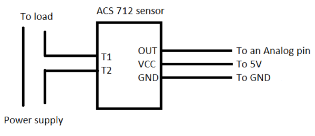

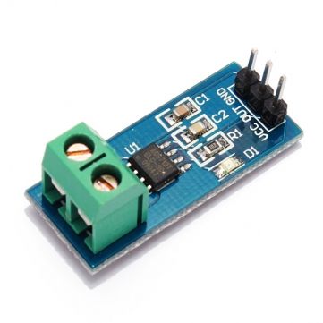

Current Sensor
There are various methods available for sensing current flow in a system. Usage of shunt resistors, current transformers and usage of Hall-effects sensors are some such available methods. In this instructable I used Allegro ACS712 sensor measuring current. Allegro ACS712 sensor operates according to the Hall-effect principal and it can be used for both AC and DC current measurement. There is no need of auxiliary circuits for this sensor it is an immense advantage over the other available methods.
This is a bi-directional measuring device and therefore this can be used for both AC and DC current sensing. The ACS712 sensor is designed for three current ranges 5A, 20A and 30A. The sensor consists of an integrated circuit which works according to the Hall-effect principal. This IC generates a voltage proportional to the current flowing in the circuit. Breakout board of current sensors based on this device also available in the market and they make your life easier.

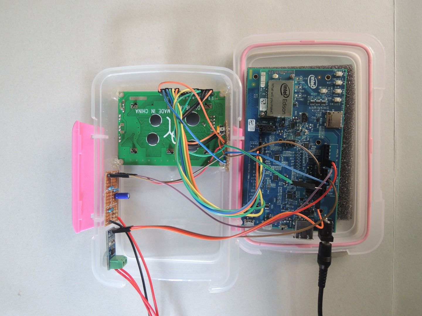

Interfacing with Edison Arduino Breakout
Following figure shows the connection of the ACS712 sensor to the Edison Arduino Base.
Complete circuit diagram, breadboard connection, fritzing project files and sensor datasheet are attached. Connect all the component accordingly.

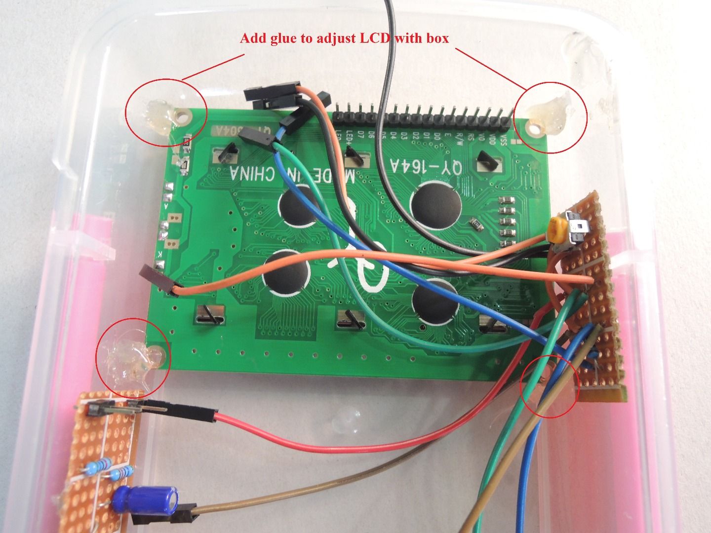

LCD Connection
Connect LCD to Edison according to circuit diagram. The connection diagram is given bellow.Connect a 330ohm resistor to the LED+ pin of LCD. Vo pin of LCD should connect to a variable resistor if you want to control the contrast of LCD or may connect to ground for maximum contrast.

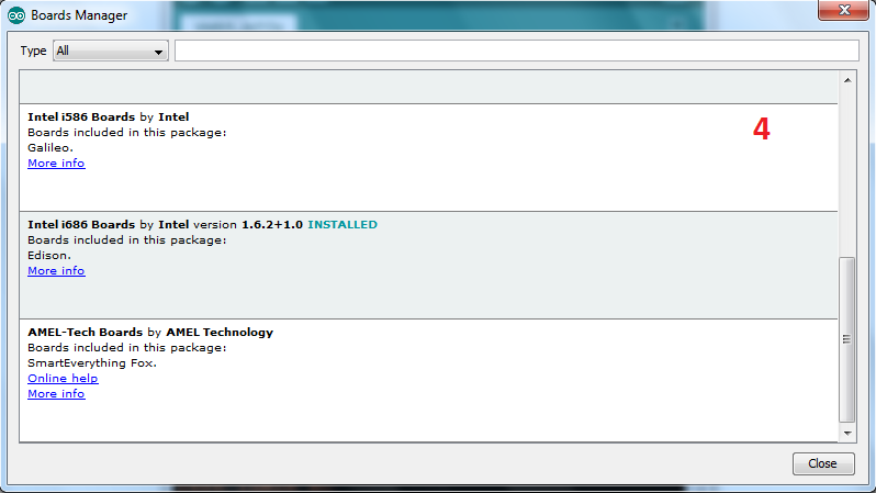

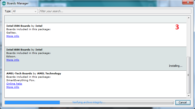

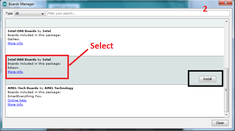

Step 8: Arduino IDE for Edison
For programming Edison with Arduino IDE first you have to download Arduino IDE from here. Download the installer and install it.

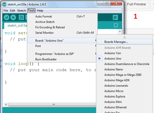

1. Run the IDE and go to the Boards Manager from Tools menu.
2. Select Intel i686 Boards and click to Install
3. Installation will be started. It will take some time to download and install. It is the time to take a cup of Coffee.
3. Necessary package is installed for your Edison board.
4. Congratulation, your Arduino IDE is now ready to compile your program for your Edison Board.

Step 11: Complete System

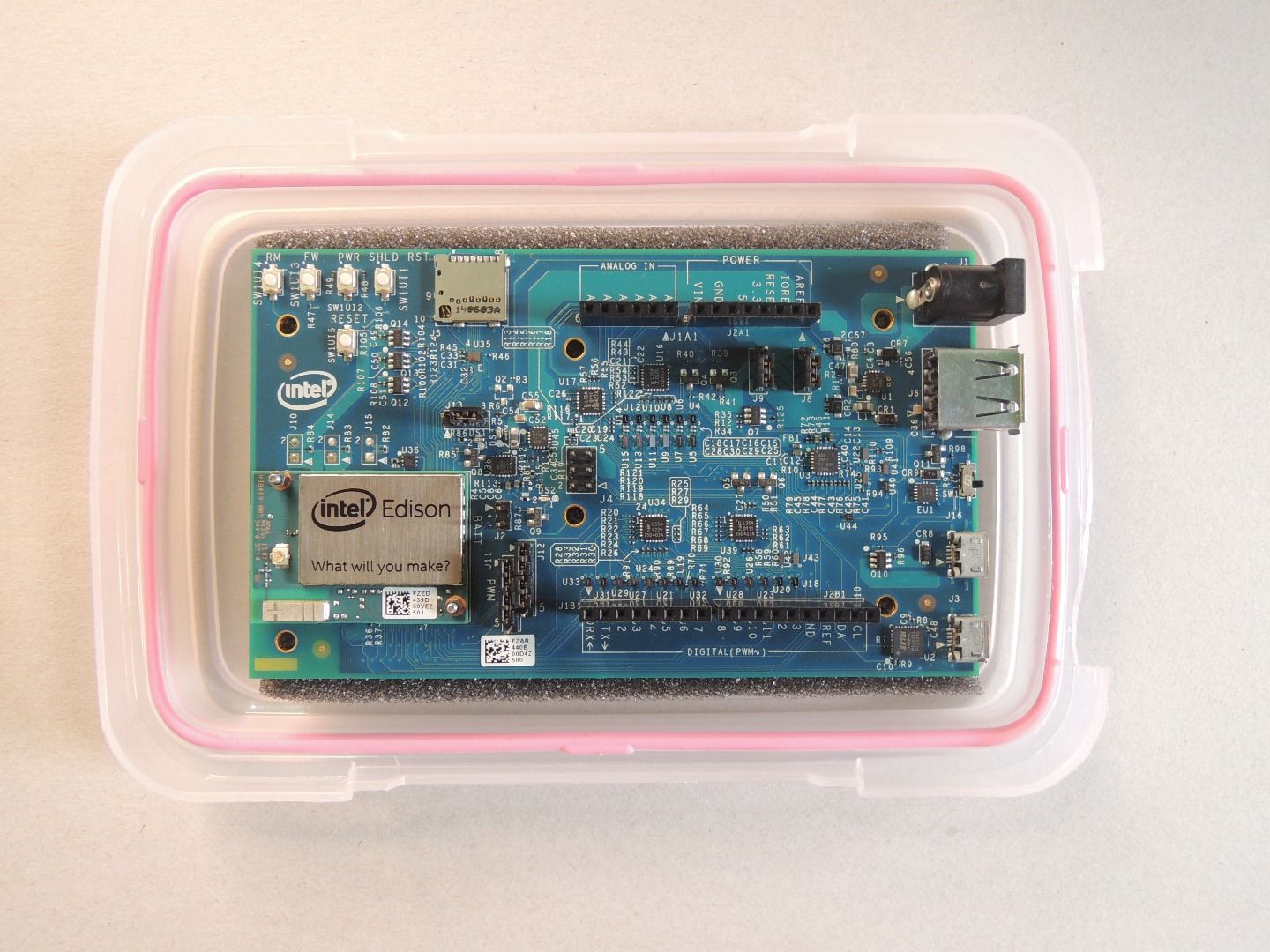

I have used plastic box as protective case for my system. You can use your own 3-D printed box. For best quality 3-D printing service you can try http://www.shapeways.com/. Here are some image of my setup
1. Cut your box according to LCD and add glue to fix LCD with the box.
2. Fixed LCD with box
3. Fixed LCD contrast adjustment circuit to box with glue
4. Fixed Current sensor and Voltage scale down circuit with box
5. Adjusted Edison to another part of box
6. Connected jumper wires to LCD
7. Connected LCD with Edison
8. Connected Load (lamp) to the current sensor. Power up the circuit and test it.

Step 12: Data Monitoring & Analysis From IoT Analytics Cloud
Different charts for the data uploaded from arduino to IoT Analytics are attached here. IoT Analytics shows different data in different color.
Following image shows the color for every data variables.
Following image represents line chart for all data items.
Every data item can be shown separately in a list form.
Min/Max line plot shows the minimum and maximum values of a data variable and the range.
