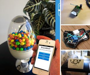

Introduction: SnackBot: the Internet Connected Candy Machine!
During the 2013 Bay Area Maker Faire, Electric Imp distributed an astonishing 40-plus pounds of M&Ms with our Internet connected SnackBot. Hundreds of attendees loved it, so we decided to share how we built it.
Our SnackBot is based around the Electric Imp, a hardware, software and cloud-based platform that makes it easy to connect just about anything to the Internet. If you are new to Electric Imp, you can check out our Instructables on Getting Started With the Electric Imp, which will guide you through the process of getting your imp online and running some basic code.
This project involves a bit of soldering (and desoldering), and should take you about 2-3 hours to complete!
Let's get started!
Let's get started!
