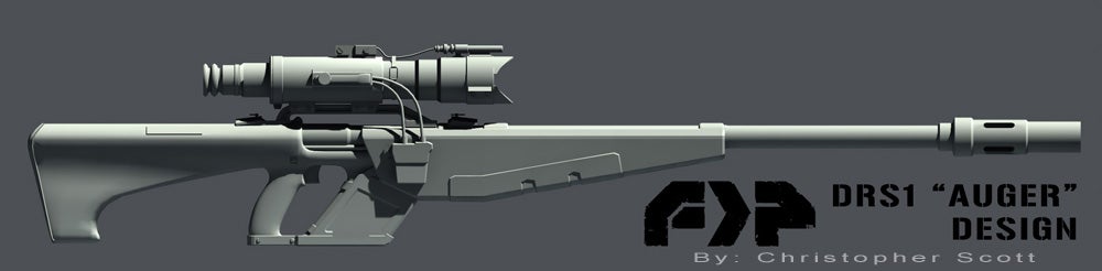

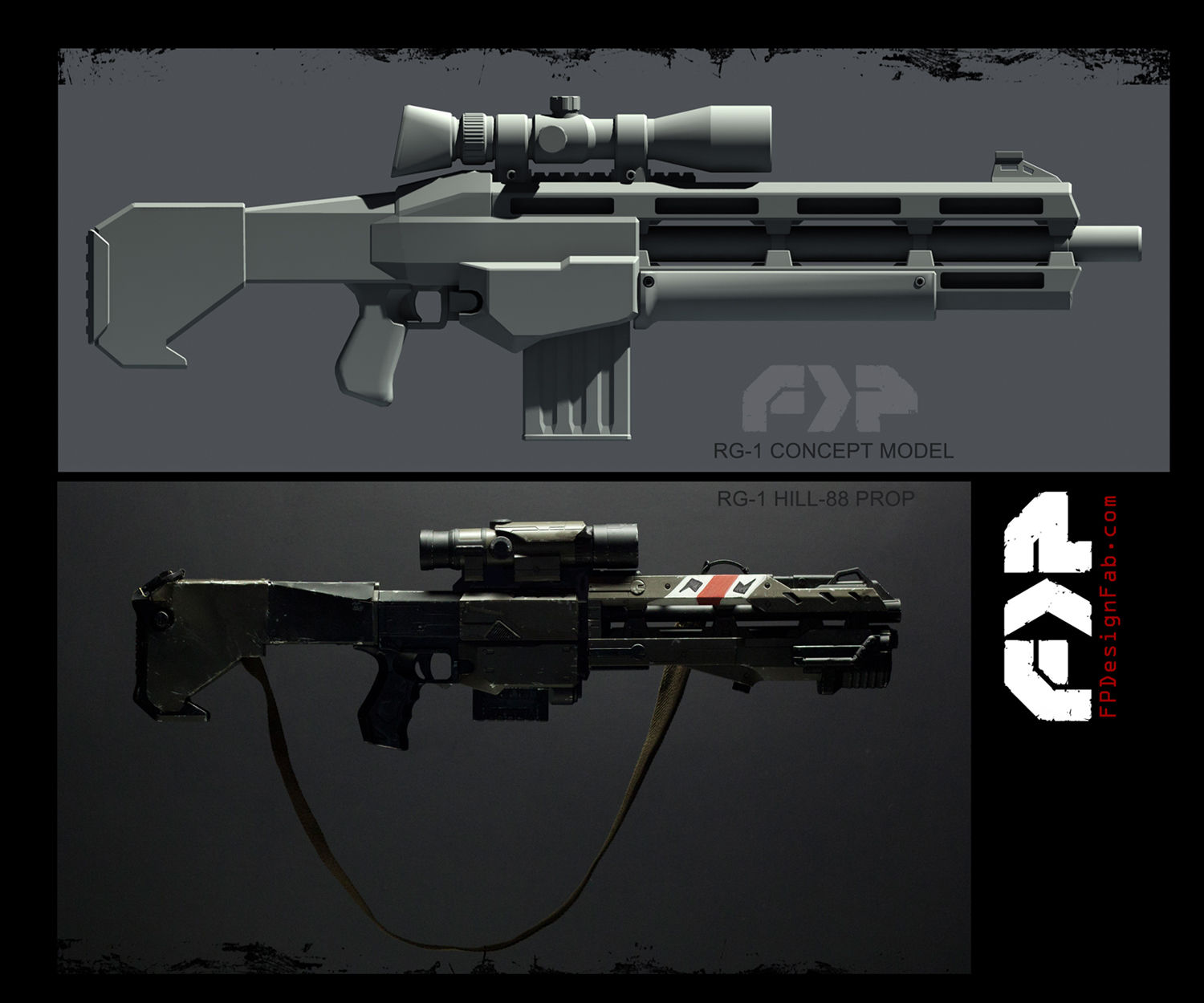

Step 2: Create a 3D Concept Model
Based on my design brief I created a 3D concept model. This design shows my goal of how I wanted the "Auger" to look.
Step 3: Fabrication
I hand fabricated my component parts from pvc and metal. I then painted all black.

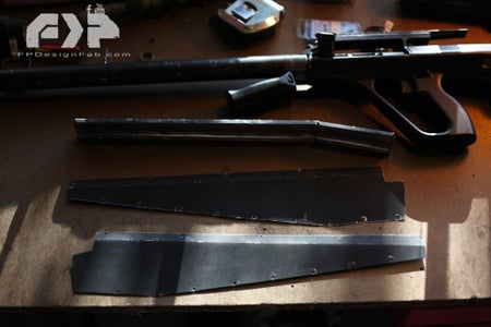

Step 4: Foregrip
I designed this prop based on the fact I would be using basic hand tools to fabricate it. I wanted a recto-linear style foregrip section. I created this piece with sheet metal and rivets. I planned to cover up these rivets with tape, camo strips and a rubber palm grip.

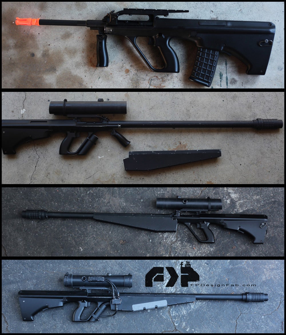

Step 5: Fabrication Steps
Here's a sequence of stages from airsoft Aug to DRS1 Auger.

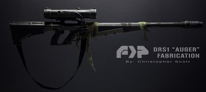

Step 6: Finished Prop
Here's my finished prop photographed in the lighting style I intended for the film. The DRS1 Auger turned out very close to my 3D concept model but not exact. I settled for whatever I could find on hand in my shop to finish the prop efficiently. This build was done in my spare time on low budget. If this was a well funded project I would have used CAD-CAM tools like CNC machining and 3D printing, etc. to build an accurate scope and ammo clip to match my concept model exactly. This prop worked out great for the style of film I was making.
