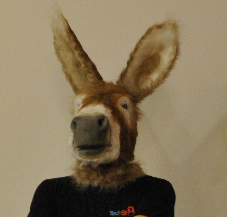

The superstructure was vacuum formed in PETG plastic over the MDF forms.
Urethane foam can be painted with airbrush paint, either using an airbrush or a standard paintbrush. Hair can be punched and glued into it as well.
Here I am cutting open the mouth and hollowing-out much of the shape to create an even more responsive part.
