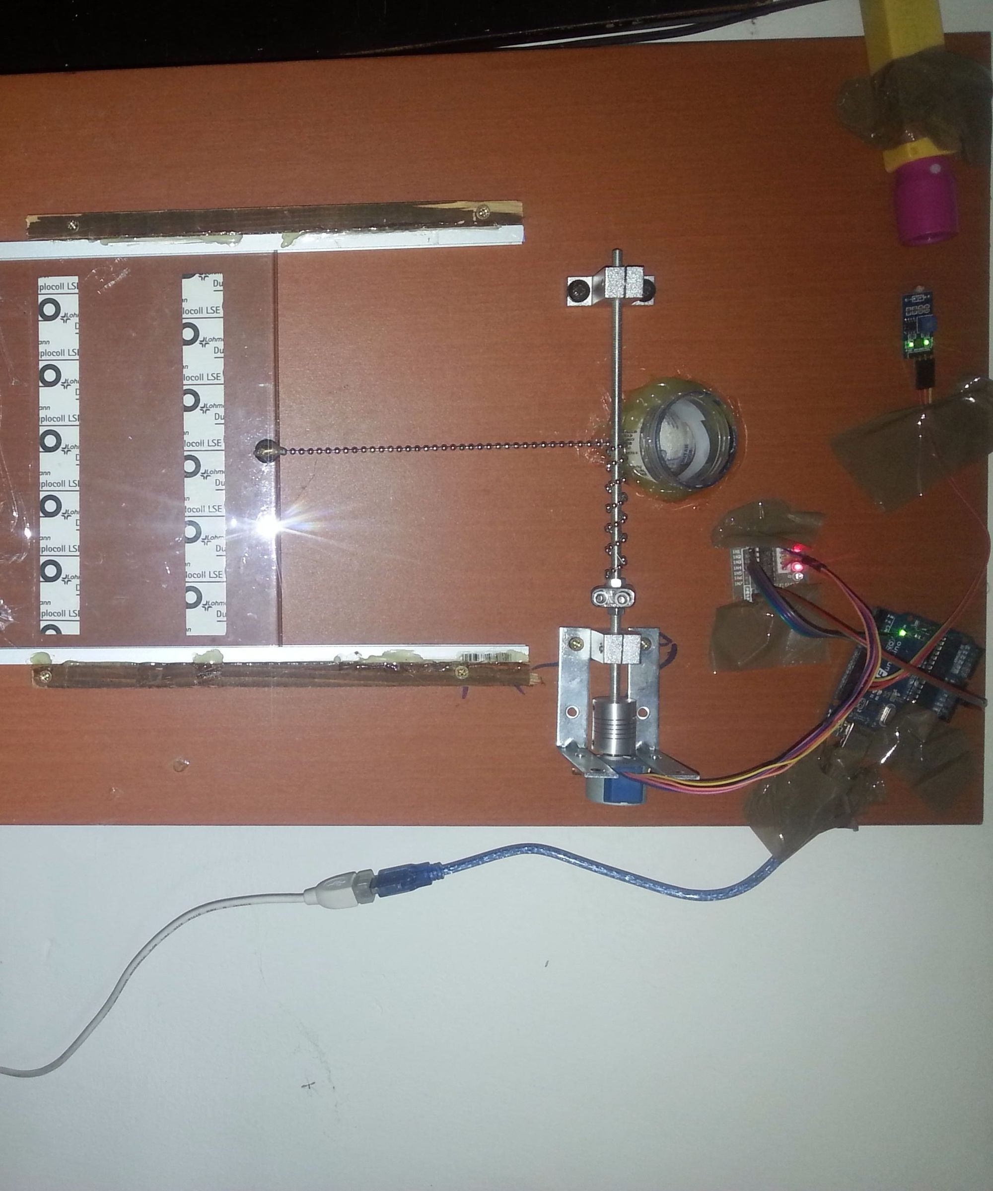

Introduction: Solar CHICKEN DOOR With Battery
Please check my previous Instructable, this is an upgrade so it runs off grid.
https://www.instructables.com/id/Automatic-CHICKEN...
Board and stepper motor are the same, the difference is in electronics as it is battery operated with solar charging. It consumes as low as 0.1mA thanks to LowPower library and cutting LED connection on the board so it doesn't draw current.

Step 2: Getting Ready and Soldering
Cut the LED connection with a stanley knife to cut LED power. I don't think it's necessary to remove the voltage regulator(as suggested by the link) as we will be using solar cell to charge our battery.
Okay, here you may want to connect things properly, but I've cut some shortcuts.
I've bent (-)terminal on ULN2003A board to allign with IN1 to IN4 to solder Pro Mini directly on.
I've also mounted Step up Module directly beneath Pro Mini. A1 is used only as mounting pin. A wire is used to connect +5V from Step up to ULN2003A board. GND kind of goes through ProMini.
Add programming headers from GND to DTR. These will be also used later to connect the battery.
Solder pin4 and pin3 for photocell module.

Step 5: Screw It in and Adjust the Trimmer
Now screw everything in and adjust the trimmer on the photocell module. Install the board in front of your coop and connect solar cell to the microUSB port and enjoy!
