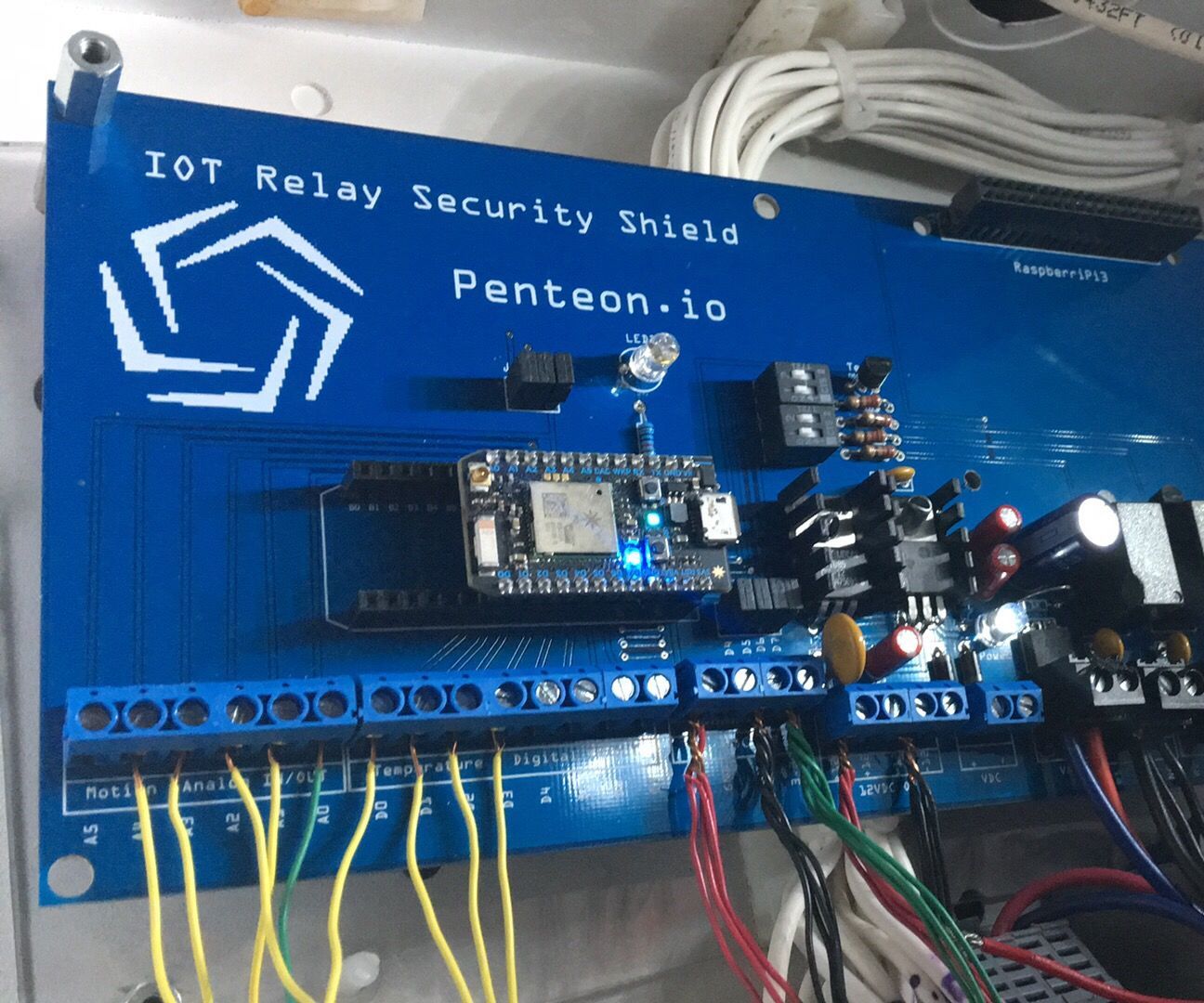

Step 1: PCB Design
The design was simple ..I wanted to be able to power the board with either 18-30 Volts AC or 12-30 Volts DC ..I wanted screw terminals because these are going to be deployed all over the place and I need a perminant solution ...
I added a temperature sensor , Current sensor , and a voltage divider circuit to monitor the Solar output and battery state ,and 2 relays controlled by the Micro Controllers through an NPN transistor.
I used a microcontroller called a Particle ..http://particle.io ..These are a great DIY device with Wifi or if you wish cellular connectivity
The electronic parts I purchased from digikey ..www.digikey.ca or www.digikey.com ..They are a parts wholesaler with everything you would need
Step 2: Soldering the PCB
1. A good soldering iron 60 Watts is plenty...Amazon.ca or Amazon.com is a good start
2. No Clean solder smaller the solder the easier it is to work with
3. A good set of cutters ..Amazon.ca or Amazon.com
4. PCB holder is handy but not necessary
5. Flux(cleaning agent for soldering tiny parts or non through hole pieces (I will demonstrate)
6. Wet sponge
7. Steady hand
Ok now if your ready have all your parts on hand ..Start from the inside to the outside ..Going slowly and methodically insert the pieces and solder them one by one.
I found it handy to have the soldering iron hot and ready to go ..Just touch the board and the piece to be soldered momentarily and add a little bit of solder to the piece and the iron at the same time ..it takes a bit of practice but once you get it ..it's easy.
Follow the pictures I'll post them in order..Hope it helps
