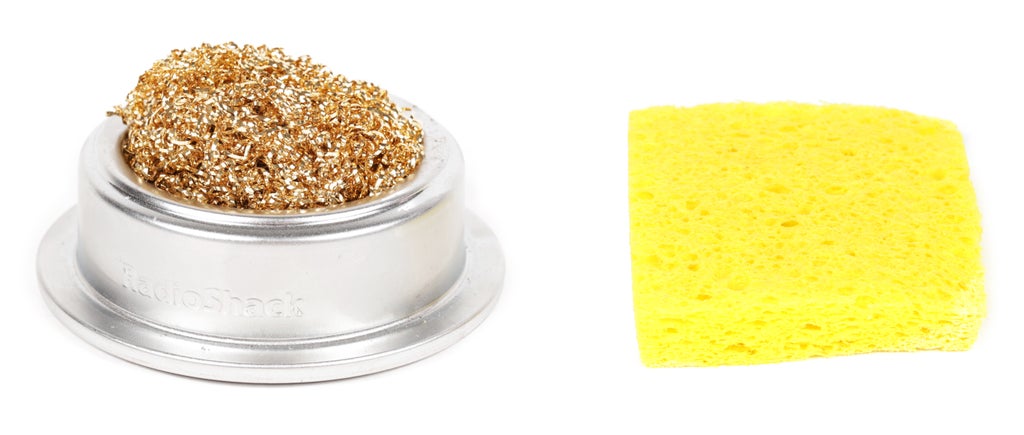

The two most popular methods for cleaning the tip of the soldering iron involves using a brass wire pad or a slightly damp sponge. Both work. However, deciding which works better is a highly contentious topic. Personally, I feel the the brass wire pad is more effective in quickly cleaning the tip. From what I can tell, advocates of the damp sponge feel it keeps the tip cleaner for longer.

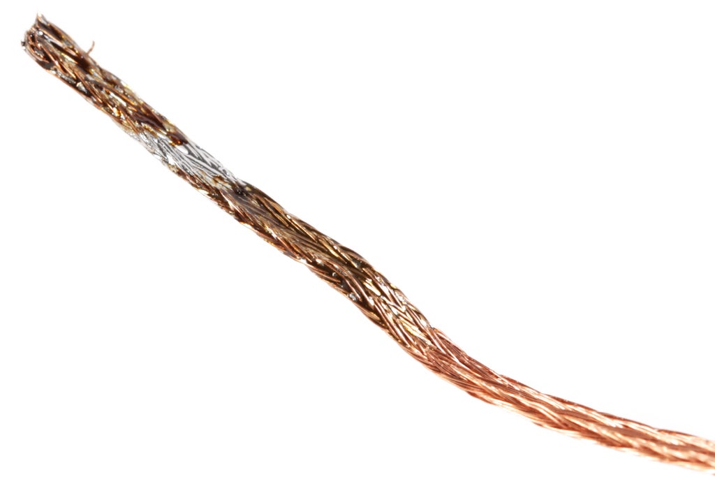

Desoldering braid is a copper mesh used to remove solder from a circuit board. When the solder gets heated up, the mesh wicks the solder away and helps remove excess. This is particularly helpful for trying to repair soldering mistakes. While this is helpful, it should always be thought of as a line of last defense.

Every time you melt solder using the tip, you will want to clean it off.
To do this, simply drag the tip 2 or 3 times across the cleaning pad.

While many mistakes can be fixed by reheating the solder, or adding a little bit more, more often than not, you will need to remove some solder. There are a number of techniques for doing this, but I have found the most reliable is desoldering braid. While it might seem complicated, desoldering braid is basically a mesh of very thin copper wire that wicks up melted solder.
To use it, simply place the braid atop the solder you are trying to remove, and press down upon the braid with the soldering iron.
You will feel the solder begin to flow and see the braid begin to turn silver. After a moment, lift the soldering iron and remove the braid from the circuit board before it can re-solidify (and get stuck to the board).
A significant amount of solder should be removed, and the mistake should now be corrected. If the mistake persists and more solder still needs to removed, wait for the board to cool off, and repeat the process.
