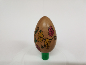

To decorate the egg I have something called an Egg-Bot. A small C.N.C. drawing machine which can be used to put images into small round oval and egg shaped objects.
The software used for the images is called InkScape and is free to download it also has extensions for controlling the Egg-bot (also free download). Using this you can take virtually any image and apply it to the object in the machine.
The one I used was made up from repeating flowers and vines. It was applied using a pencil, however I found that the polished surface was too smooth for this so I had to sand the egg with 230 grit Abranet, but this still would not work - I found that the pencil was too light to draw on the wood, so I adapted the Eggbot - adding an elastic band between the drawing arm and the securing screw - this held the pencil onto the egg while it was rotating and worked just great. I also had to ensure that the pencil had a sharp point to it, I didn't have a sharpener so I use a little sand paper (Abranet).
Once the image was there I used Pyrography to burn it in place and then coloured it using iridescent paints

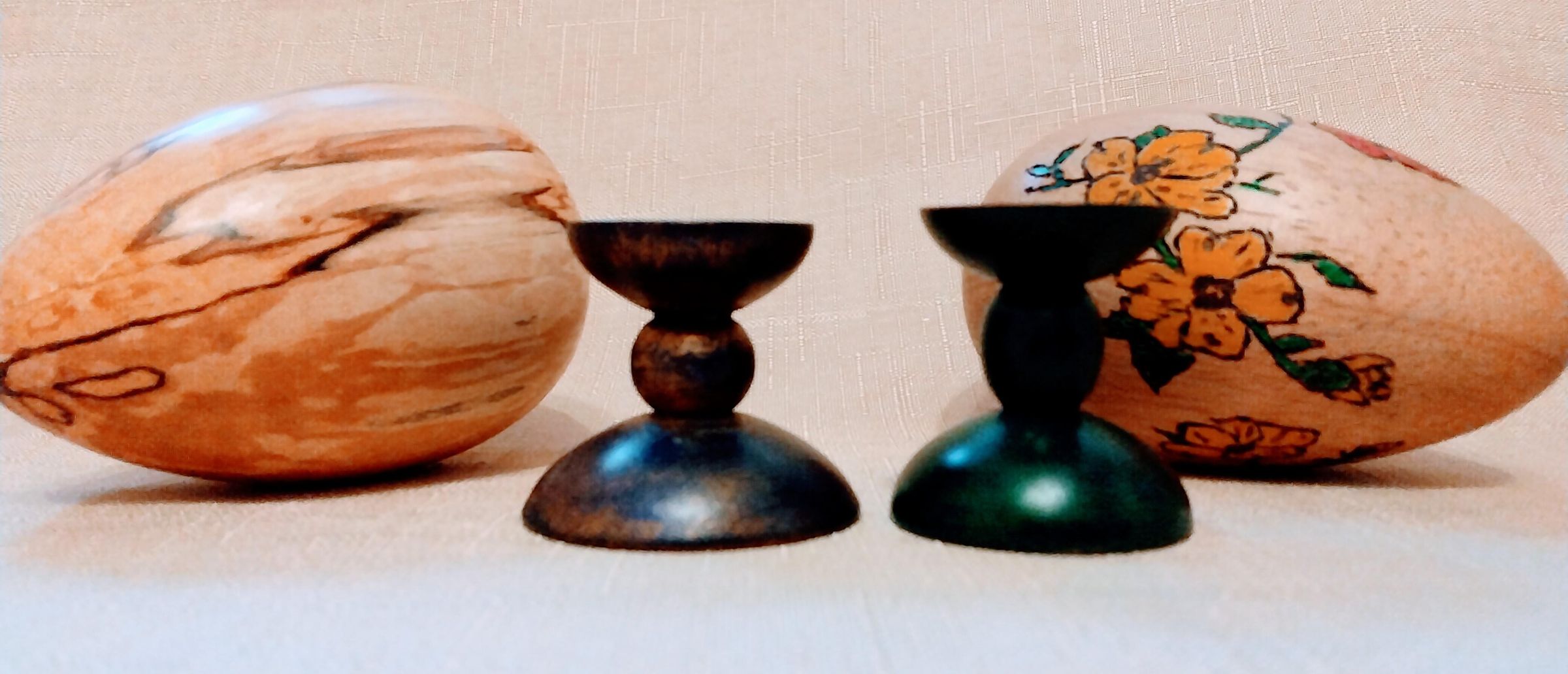

Adding a base
The eggs I made were great and very decorative (the second one I did not colour as the grain was fantastic by itself). But the both needed something to sit on to show then off. So I turned a couple of bases using some scrap wood and painted them, giving both a slightly distressed look.
To do this I first painted them with black acrylic paint and when dry applied some of the iridescent paint - Blue for one green for the other. just before this layer dried I buffed them with a tissue - this removed some of the paint leaving a patchy look. The green one I allowed to dry fully and then polished it up, for the blue one and added some gold guilt creme and buffed it - the guilt left a patchy look making it look slight aged this was left to set a little more and then buffed to a shiny / slightly mat finish.
