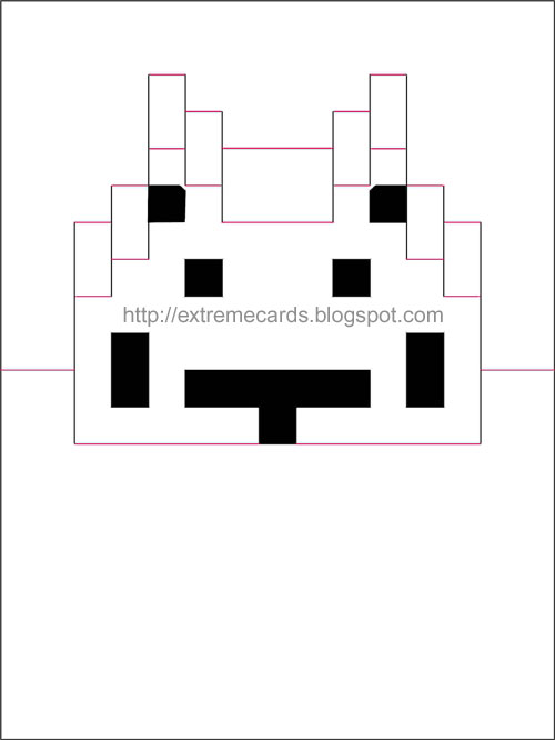

Download template in PDF, or DXF page 1 and DXF page 2.
Page 1 looks like this.
space invader pop up card
Page 2 looks like this.
Step 2:
Cut page 1 and 2 from contrasting paper colors. I cut page 1 from purple and page 2 from black.
Cut pieces on black cut lines. Score on red fold lines.

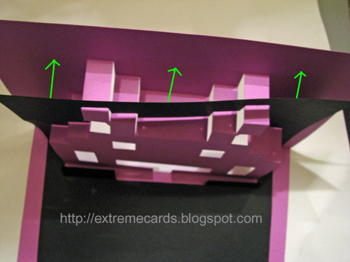

Start working each fold line into place by pushing the space invader from the back of the card and pinching along each fold line on the front.
Warning: work on the single cubes at the top very gently. Each is attached to the rest of the antenna by a fragile triangular bridge.
Working from the back, push each cube forward, pinching the folds on the back.
Start closing the card.  As the space invader collapses, continue to crease each fold line until the piece folds flat.
