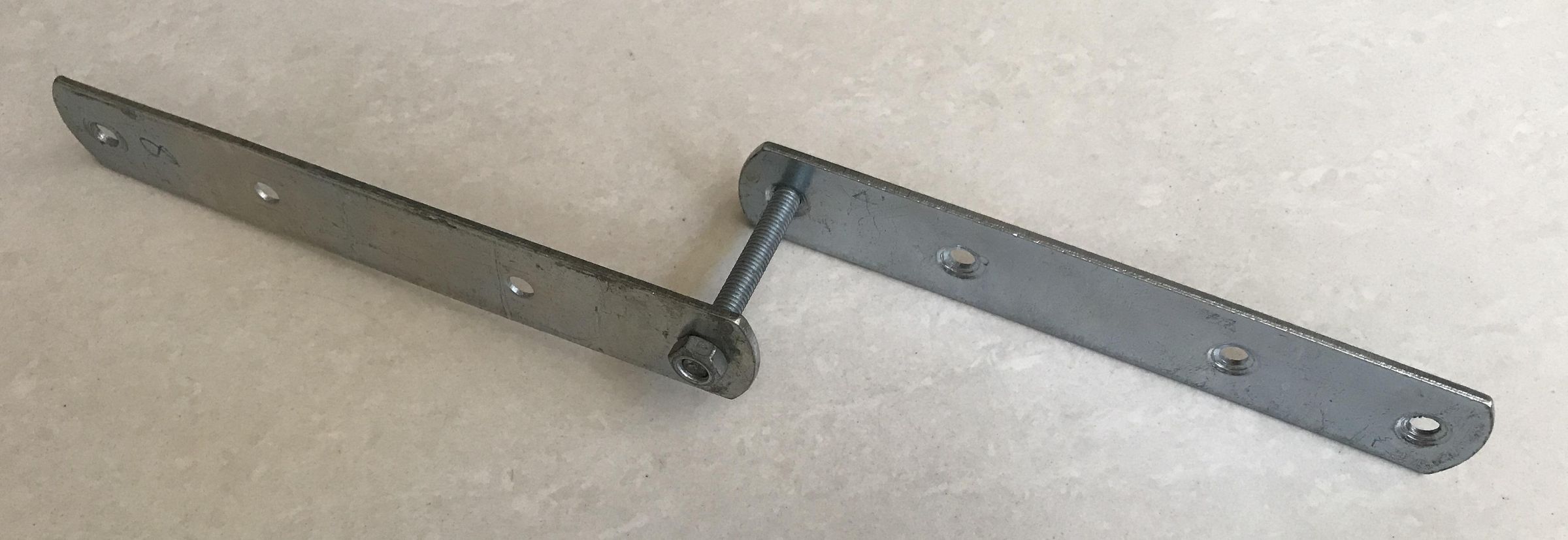

I drilled a 16mm diameter hole in the 2pcs x straight brackets and installed F688ZZ (8x16x5 mm) shield ball bearings into those holes.
Then I connected two parts above and a 100mm aluminum profile together, which created a shoulder for the robot. And the robot's elbow was also made in a similar way. I took advantage of existing drilled holes without having to drill additional ones. It's nice that these straight brackets were all pre-drilled for M5 countersunk bolts.
As you can see, the robot arm's shoulder and elbow were joined through an 8mm shaft, about 65mm long. For the elbow, I used an additional 60 tooth gear to drive it.
Once the arm was done, it could be rotated freely without getting stuck. There was a small gap between shoulder and elbow arm because I used M5 countersunk bolts and one ball bearing to fix this gap.
