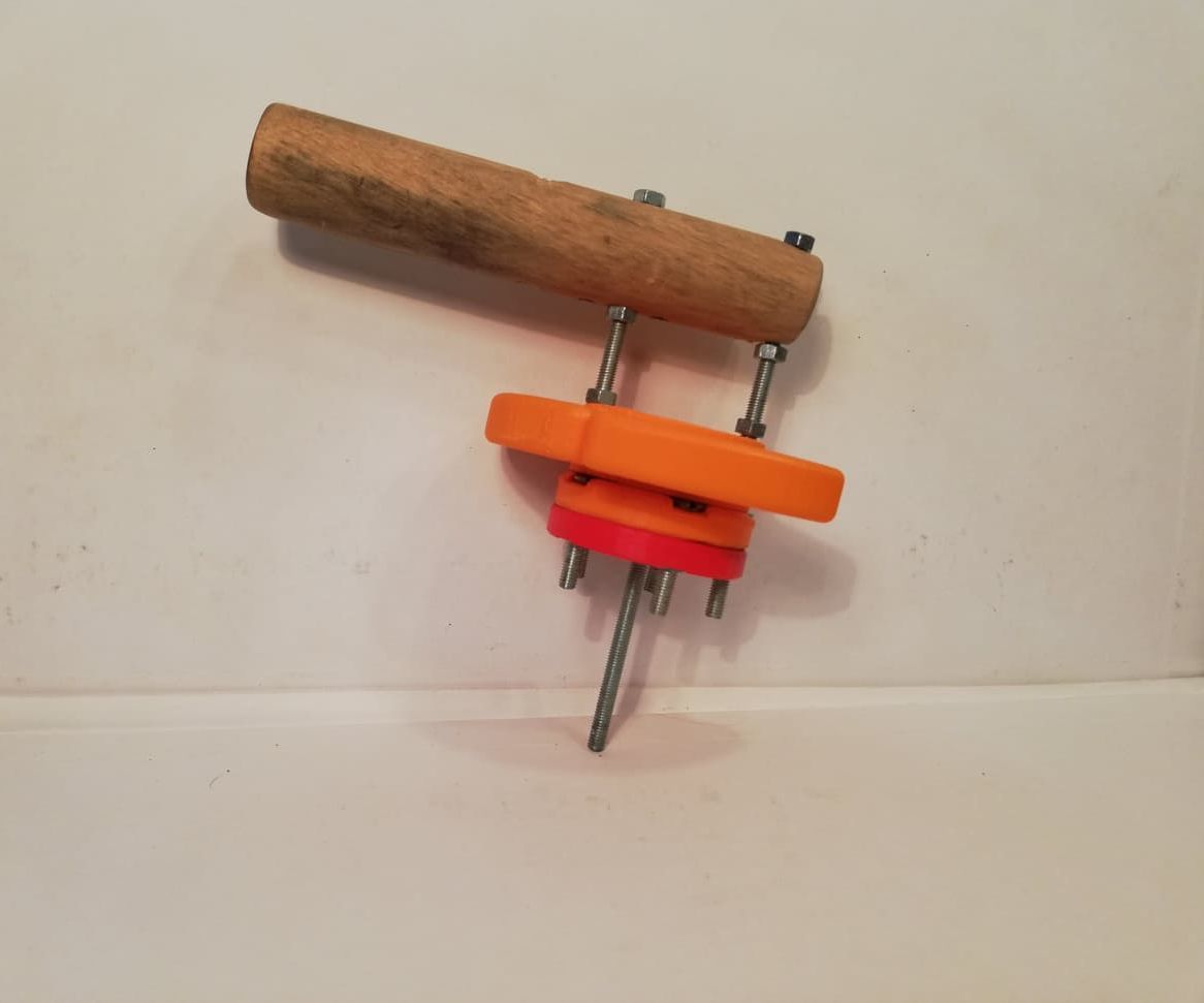

The base of the crane is made out of plywood, bearings, threaded rod, lock nuts and bolts. It is secured to the table using 3d printed clamps or just regular clamps.

The stamphead is a 3d printed piece, .stl file is added.
