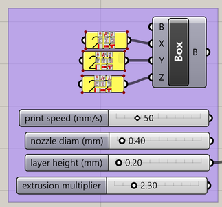

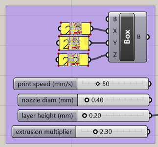

I modified the basic cylinder code to create a star.
My plan for this assignment was simply to alter each of the 4 pictured parameters (print speed, nozzle diameter, layer height, extrusion multiplier) so that I could better understand their functionality.
