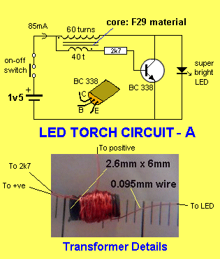

To run a LED from single 1.5 V, 1.2V or in particular largely depleted batteries, the famous Joule Thief circuit using a coiled toroid is great.
However, when salvaging the solar cell and battery from a cheap solar garden light to make a charging circuit, I realised the electronics are in fact a simple LED driver. The only part involved in the charging is a diode. So I took a new diode for the charging project and used the complete little circuit board as a Joule Thief for a cyborg zombie.
I used solar garden light bought in a package of 4 for 10 euros at [www.conrad.be Conrad] under nr. 572759. If you happen to have another use for the solar cell, on-off switch and battery, as I do, this comes very cheap for LED + driver circuit. You can simply cut the wires from the solar cell and just leave them like that. Replace the battery with the one of your choice (or keep the one from the solar garden light) and you're ready.
The circuit from the solar garden light is bound to be at least somewhat more efficient than the famous three-parts-joule-thief. The latter is great with almost dead batteries, but so is the solar garden light circuitry. Tests show it works till the battery voltage drops to about 0.6V. While toroid three-parts-joule-thieves are reported to go to 0.3 V, the ones I managed to build mine also need about 0.6 V.
