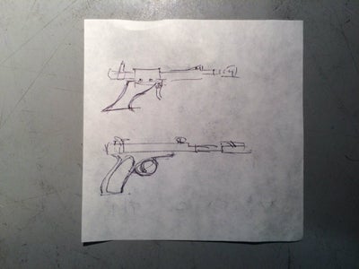

Step 1: Design.
I made a few sketches to keep me focused on what i had in mind for all the pieces i found. Unfortunately i never took a photo of all the gathered bits. (since this is my first ever instructable it's a little after the fact)

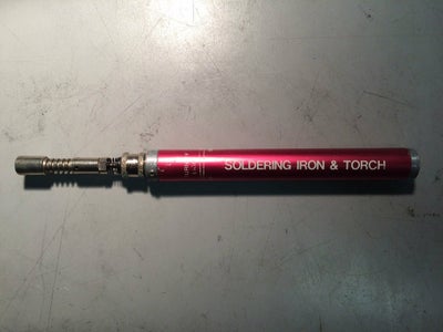

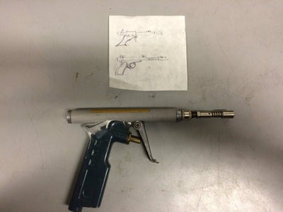

* A dysfunctional butane soldering iron/blow torch

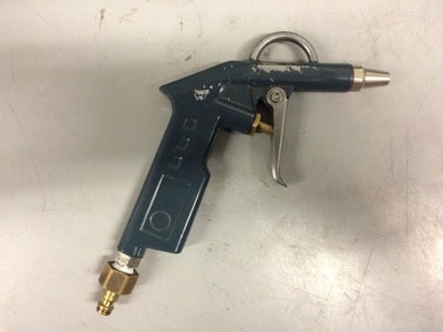

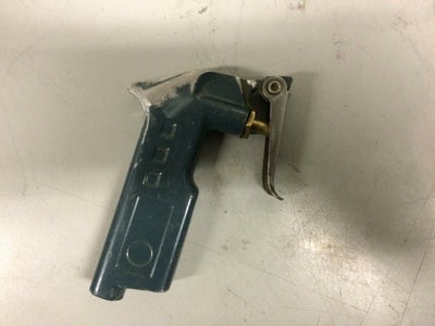

* A broken Air pistol from a compressed air system

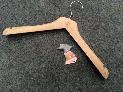

* A wooden coat hanger
* Some off-cut pieces of copper and brass plate.

Step 2: The Barrel
I used this butane soldering iron for the barrel. I thought it really looked the part especially after removing the finish with a quick sandblast. Sandpaper would work equally well, but i really like the even matte look of the sandblasted aluminum.
Note:Remember to mask off all the bits you want to avoid sandblasting by covering it with tape.
Step 3: The Handle

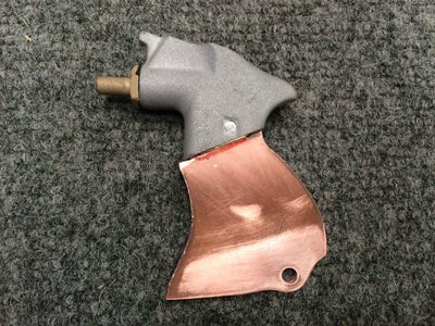

These airgun handles are ideal. The trigger mechanism is built in and very simple. I used the overhead mill on a lathe to mill away the existing barrel and make a half round channel all the way down the top. This was to accommodate the barrel I had made from the butane torch. A half round file and a bit of filing would also work. I decided to cut the bottom (grip) off of the handle and replace it with a custom made grip.

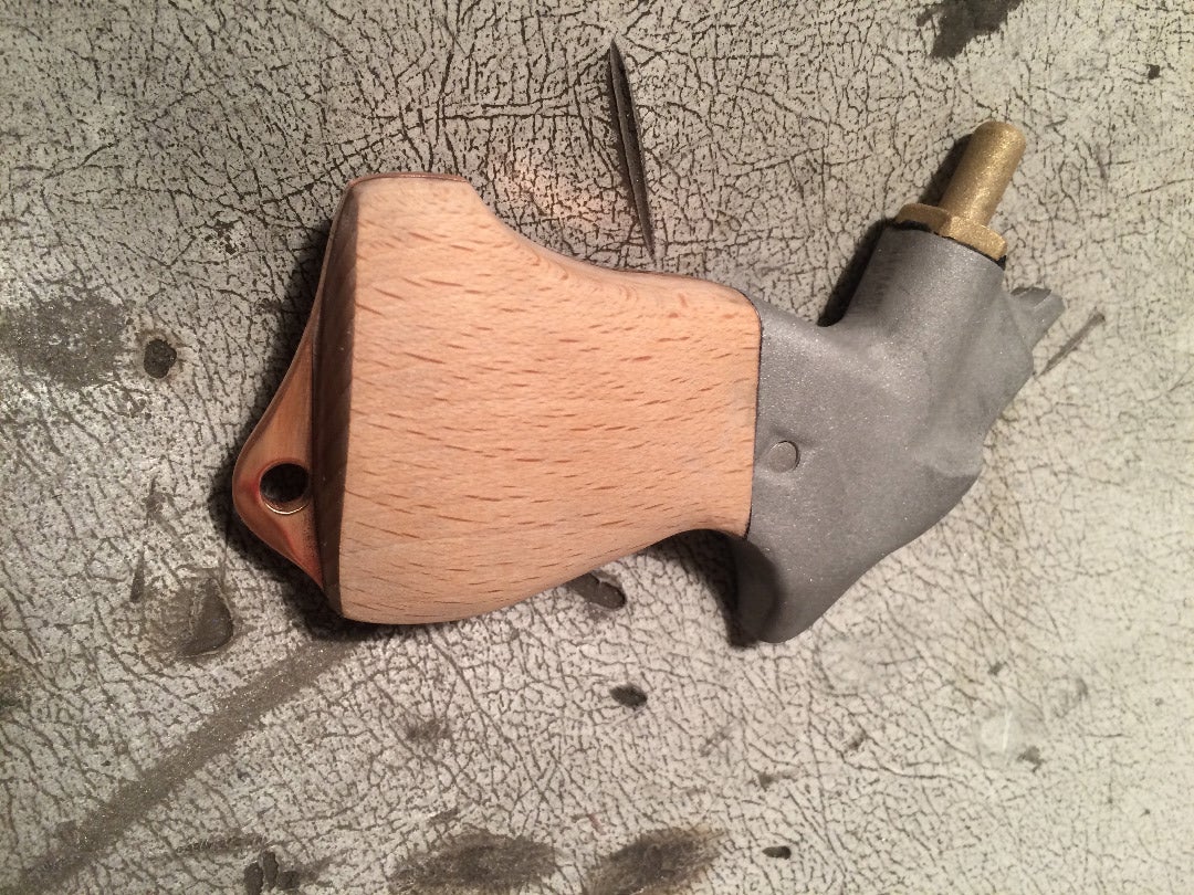

Step 4: The Grip
There aren't many pictures of the grip during construction, but I will at least explain briefly what i did. Using a piece of paper i drew the shape of the intended grip and holding it over the handle added a bit on top. This extra bit had to slide into the hollow left in the bottom of the handle. I could have kept it simple and just glued it in place, but instead i drilled a hole on the one side and recessed a screw to hold the plate in place.
Note:You can see that i also sandblasted the handle to remove the old paint and it ended up matching the barrel perfectly. Unfortunately while I was tapping a hole and fitting the screw i broke off the trigger, something i would have to attend to further along.
Step 5: Wood for Grip
The wood for the grip was harvested off an old coat hanger. I simply cut the two ends off the hanger and used epoxy and a clamp to stick them on. Once they had dried i sawed the sides flat and filed them into shape. I used a sheet of 180 grit sandpaper to finish off the grip and then treated the wood with a liquid wax.
