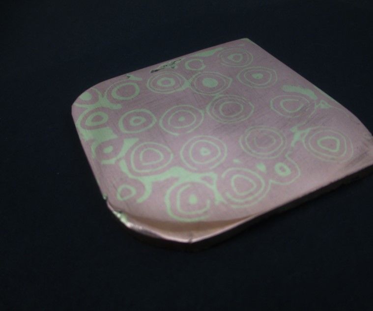

2 years ago
Hey there DC-Labs,
I've watched your setup a while ago, and used your diagram to make my own. Based it off a doorbell-transformer. The bell transfomers tends to get a little warm after running a while, so I will add a fan still.
I made a similar style etching pad with felt, but the metal underneath turns black very quickly. It seems like this stops the etching/marking as good as it does. Did/Do you run into this as well?
I have been using it for etching and afterwards marking, so DC and AC are working fine. I have included pictures below.
Cheers!
Reply 2 years ago
Hey your build looks great.
Yes, the cathode does corrode. The electrolyte can be pretty nasty. Some folks use salt water, others use some form of salt and vinegar. I use a commercial electrolyte for stainless that smells like sulfur. These are not friendly to metals, even "stainless steel."
I shine it up the cathode steel with some 120 grit sand paper whenever I change the pad. Maybe three times a year. I have found that most cases of poor etching is result of not enough electrolyte on the pad.I have recently been pieces cut from felt insoles from the shoe department which is thicker than craft felt.
Thanks for your comments and photos.
DC
Reply 2 years ago
Thank you for your reply and confirmation. I expected it was a normal thing to see, since AC wave works on both pieces (removing and putting back carbon). I just didn't expect so much so soon, but that could be due to the workpiece as well.
Made my first proper example piece as included, etched with DC first to gain some depth, then with AC to mark. Proudly mounted on our mailbox.
Thank you for your tutorial, I've now gained a new skill after finishing this build.
