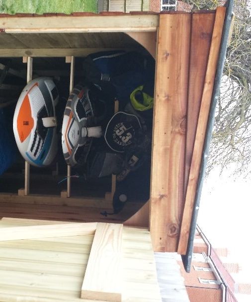

Step 1: Making the Step Supports
Take the 3 step support sections, which have been cut to 140mm long. These need to be marked up according to the dimensions of the pots that you intend to store on the shelves. The depth of the planter is 600mm I set the height of each of my shelf sections to be 450mm.
If you look at the final construction, the shelf platforms themselves extend forward of these step supports. It is most important not to take too much material away from these supports as they are load bearing. Better to extend the shelves outwards rather than cut too far into these timbers. From the marking up images you'll see that I cut approximately half way into these timbers, but not much further.
Once I was satisfied with my design, I cut the the waste away from the marked up section. I then used this as a template to mark-up the other two. These where also cut using a jigsaw before cutting those.
