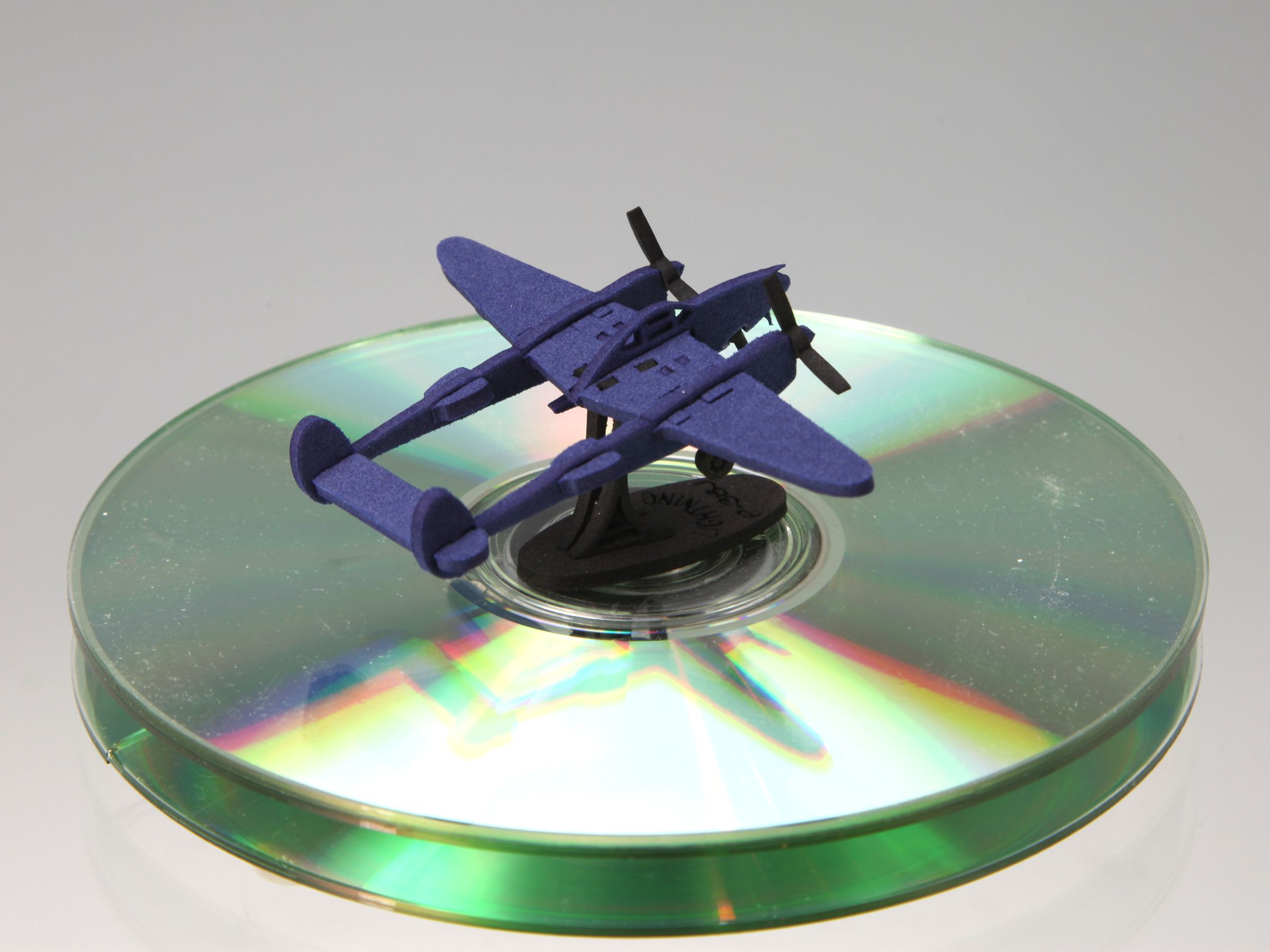

Since I had access to a DIY laser cutter, I opted to cut the frame silhouettes out of black craft foam
I made two animations - Rumba and Stick Dance - for your enjoyment so far. The animation files here are in the SVG vector format and the NGC format if you wanted to cut them on your CNC laser cutter, such as the Epilog :)
I do realize that not everyone has an Epilog at their disposal (at least not yet :) ) and so the size of the figures is kept within 1.5" to fit on the Groover's Pocker Laser Engraver. The SVG file can also be printed and the silhouettes meticulously cut out with small scissors (anyone here up to it?) or I imagine a PC-connected paper cutter, such as Cricut for example could be used. I did not try these on paper but see no reason why they would not work, especially if the paper is a heavy card stock
The Rumba animation was created by cutting 12 frames at equal intervals out of a Rumba dance video (I would love to credit the lovely dancer but cannot locate the source at this time - the animation was made some 6 months ago). Then the dancer's silhouette was separated from the background (12 times!) and traced in Inkscape to convert into vector format. Rather tedious work that took several hours.
Making zoetrope animations from video is a lot of work, obviously, and so I also looked for a different way of creating the frames. It turned out that there is a software out there, called Stykz, designed specially for that! Stykz is perfect for creating these animations because you can control the stick figure very precisely and you can plan your animation out by creating the exact number of frame you need (12) and then working your moves into them. There are some template stick figures you can use and then you can let your imagination run wild, unlike working from actual video where you're limited to what's been filmed.
I am not qualified to instruct anyone on how to use Stykz but I encourage you to stop by their site, grab the free download and check out their tutorials - you're guaranteed to find your way around the software in a matter of minutes.
The Stykz results can be exported as PNG files containing individual frames which can then be traced in Inkscape and either printed or converted for cutting out either on a laser cutter or on a PC - connected paper cutter.
Once the 12 figures have been cut, make sure you glue them to the outer rim of the CD in the right order! Direction does not matter but the order is very important . I found it best to glue the frames right away because some of the intermediate frames may look alike and the wrong order will definitely mess the motion up. Super Glue (Locktite Gel Control Super Glue works great) is the best glue to use because it grabs and dries fast enough to move onto the next figure as soon as you've positioned the previous one.
I will be very happy if the readers make their own animations and post it either on my blog or right here.
