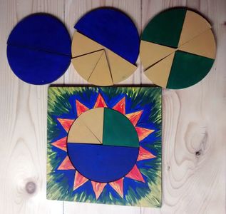

I wanted to make half circles, quarters, and eights so that they could all fit together. You could also use other fractions (thirds, fifths).
I cut out 5" circles and fractions.
Base

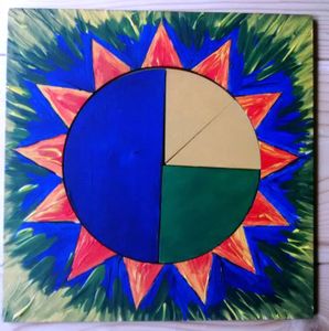

I decided on a 8" by 8" base to fit the circle pieces in to. I chose a very simple design (sun/star) to rastor on to the wood around the cut out circle. I will likely do other iterations of this base in the future with different designs (caterpillar, flower, etc.)
After cutting out the pieces using the laser cutter, I sanded down all of the edges of all of the pieces (including the base).
I tried every iteration of the puzzle to make sure that all of the pieces would slot easily into the base.

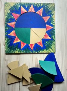

Using acrylic paints, I color coded the circle fractions:
• half circles: Blue
• quarter circles: Green
• eighths: Yellow
I then painted the base for the puzzle.
Once dry, the project was complete!
