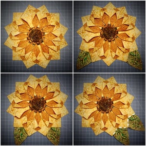

    1. Attach petals:
      1. Place two blocks "side #2" together, making sure brown points are in the same corner
      2. Sew the two blocks together using one of the template lines
      3. Open up the two blocks and repeat with a new block, now using the other template line. Keep adding blocks all the way around the wreath until you finally sew the last two together
    2. Decide which sunflower look you like better: The points of the petals need to be secured; you can either sew the petal points to the other point on the same petal, or the one right next to it. They give very different looks. I went with option two!
      1. Hand sew or use machine to sew corners of SAME petal together
      2. Hand sew or use machine to sew adjacent petal corners together; use iron to create creases. You may even need to use fabric glue to keep petals from falling
    *You could be done after this step and not add the brown center or leaves if you wanted to use this as a table centerpiece.
    Step 4: Sunflower Center and Leaves
    1. Center:
      1. Use Center template provided to cut out (2) brown circles and one batting circle
      2. Lay browns right sides together with the batting on top, and sew circles together leaving a 2-inch gap opening
      3. Turn inside out and press
      4. Hand sew on black beads through only the top fabric; the flower opening is small, so keep the beads close to the center
      5. Place brown circle underneath the center of the petals and mark with a clip or pin where your brown center opening is; you will stuff this with poly-fil later
      6. Sew inch (or so) sections around the circle as pictured
      7. Add poly-fil to your desired lift; this is added for depth
      8. Finish sewing brown circle
      9. Decide if you want to leave the petal's brown points laying flat (#1) or flipped up (#2) (I did this!); they both provide different looks
    2. Leaves:
      1. Use Leaf template to cut out (4) green leaves
      2. Sew two leaves, right side together, flip inside out, and press
      3. Fold leaf in half, use your friction pen to mark a two inch line up from the base, and sew a 1/4" seam from the folded edge; this gives the leaf some movement and depth
      4. Top stitch an 1/8" seam around the edge of the leaf
      5. Position leaves in desired placement and sew onto petals
