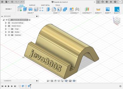

In the axis y and z draw a model of the lateral part of the support for mobile. In this case, the draft has a little part that you can see difficult but in the end, it's really easy to draw.
On the floor draw 3 lines 32.18-40-11.18, these lines serve before doing other lines with an angle of 116.7 and 63.4.
Be careful these lines don't have a limit, just draw too much large that you want and with tool modify cut, eraser the rest of the line.
Step 2: Corners in the Piece
Finished the other part, we start to do the corners of the piece, with the tool fillet that is on part of the tool of modifying. and do the corners with an angle of 2 or 1.5.
To generate the curve of the V that we form with the same tool we can do, only just change the angle that is going to be 20 and 10.

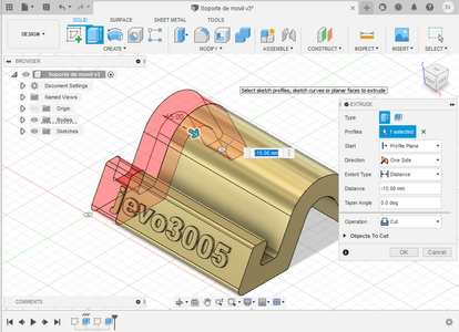

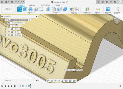

Step 3: Extrude
Extrude the piece, with 90 on the same axis, this we do in the two locations it's on the top bar of tool and click on extrude and resalt all the piece, another way it' resalt the piece, and then right-click and search extrude on the small bar, and writhe 90.
Also here we can do another extrude for the name, in the front part.

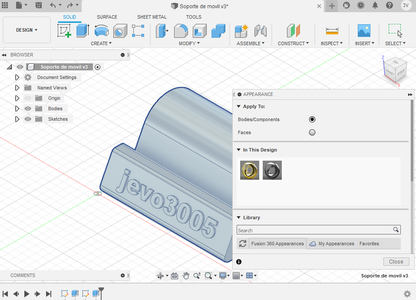

Step 4: Sketch With Text
But after doing that, we need to create a sketch there, and with the tool text, write our name and we can edit the type of letter and the size. We click on finish sketch and select the name (this is the sketch, so normally all resalt) and do a extrude of 2.
Step 5: Apperence
And to finish put a color (the appearance) there in the support. This is too easy so just double click all resalt and see the option of appearance. And we have different options so it's a decision of you.

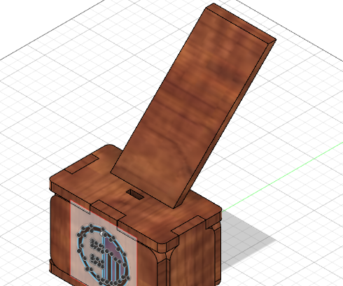

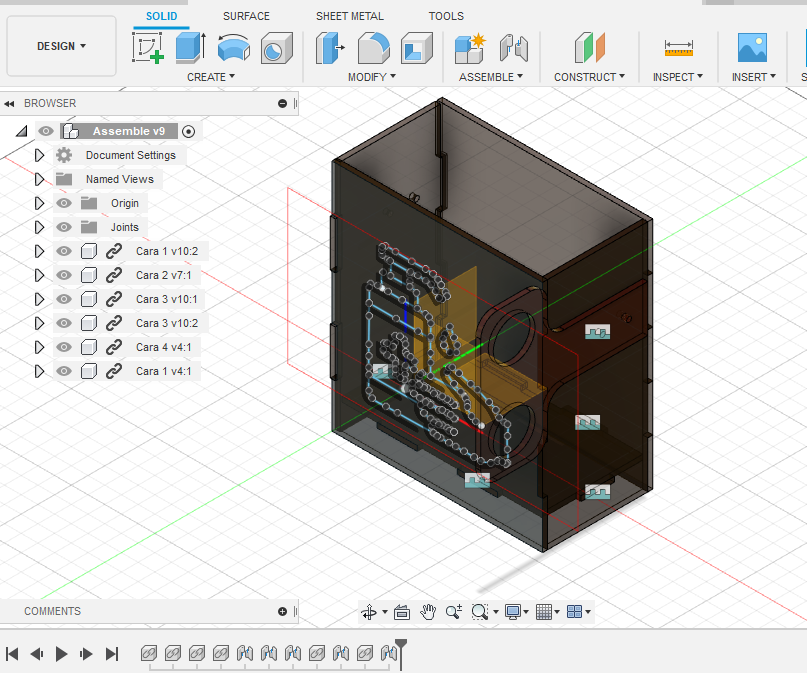

Step 6: Model Box 3D

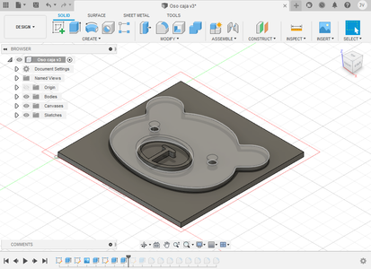

For the second part, we have a small box. with a extrude of 2 and the high of the other part 15. And there we need to draw the other part.
For this, we need to use the axis x and z, which's like the base of the box, and after that this object gets form.

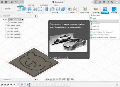

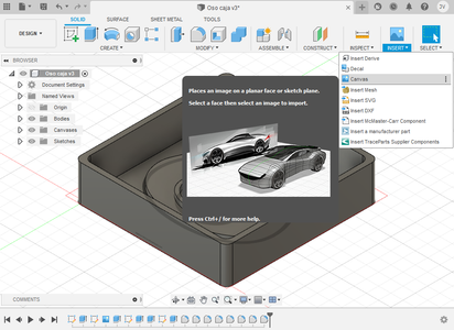

Step 7: Insert a Picture
To do the other step we need to create a new sketch and there insert an image in the format canvas. Without filter just the image with the border in black, that serves at the moment when with the tool spline, cover all the lines.
Step 8: Spline Piece in Piece
With the tool spline, we need to draw and try to do the best, to don't have mistakes at the moment to use the 3D printer and don't see extra lines.
Then extrude for up or down, and according to your picture, the variety of the extrude is different. In the end, you just see an image in 3D.

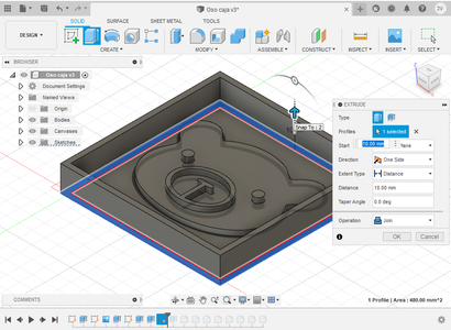

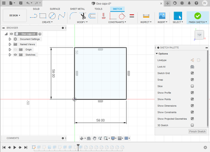

Step 9: Extrude the Border

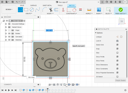

Then draw in the border of the square, another square of 58x58 and with an extra 2mm. This serves to do an extrude of 15 to up and with that finished all of the box model 3D.
Step 10: Filled
With tool filled we can do that the borders have a corner, and don't see really boring the small box that we made, and at the time to show to the public show more attractive product.
Also what I was forgetting is that this tool can perfect the borders of our draw that we did, in the case of this doesn't have a shape that we want.
