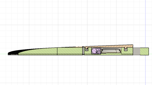

The parts were designed in Fusion360 based on these existing Thingiverse models. The fins are designed for the FCS system. I made a large fin and a small center fin as commonly used in rapid surfing.
As already mentioned, each fin consists of two halves. The space where the LED and coin cell fits is surrounded by an elliptical groove into which a gasket is inserted. The gasket is squished together by a ridge on the top part with a triangular cross-section.
All stl files are attached below.
