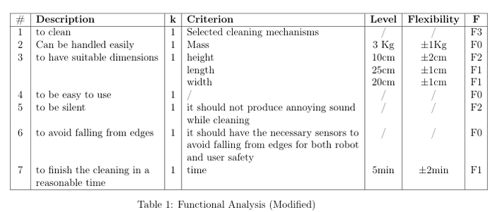

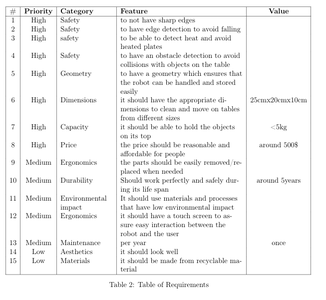

Step 1: Project Working Modes, Functionality and Requirements
its primary interactions are the table’s surface and edges, as well as different types of dirt on the table. Additionally, the robot will deal with obstacles on the table, such as plates and cups, ensuring effective and efficient cleaning. All this will be taken into consideration in the following steps

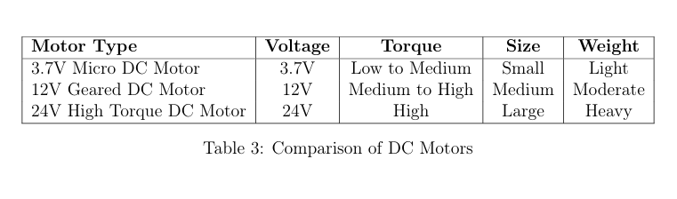

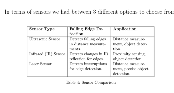

The main issue to surpass in our project is for the robot to detect and avoid falling edges. There were three types of components that we needed to compare:
• Motors
• Sensors
• Wheels

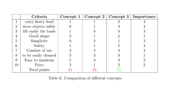

Rubber wheels were the better option as it full filled our project needs and was easier to obtain and had simple control in programming Regarding the final design we went with we had four different designs mainly having different concept for a gripper but ultimately we decided to scrap the gripper and go with a design that had a small weight and a brush in the middle

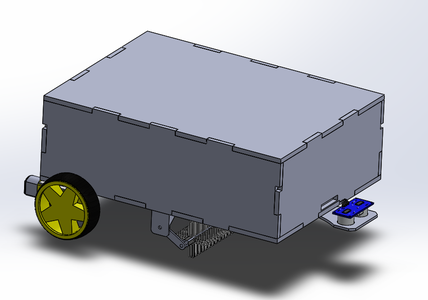

Our project consist of simple parts divided in cleaning unit, driving unit and sensors shown in the figure below.The goal of the prototype is to move autonomously while cleaning the table on it’s patch with a roller brush, The behaviour of the prototype can be described in the logic diagram
Step 4: Mechanical Design

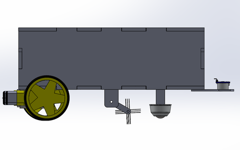

When designing the prototype the main requirement that surfaced was to design the prototype as compact and light weight as possible. With the limited time, Budget and equipment we realized that achieving the full goal of the project would not be possible so we decided to go layer by layer achieving bare minimum in our project to make an affordable and easy to reproduce robot that can clean the table without falling off the table.
We used two rubber wheels with two 3.7v Dc motors along with a caster ball wheel in front of the robot for better turning which are held to the body of the robot using 3D printed mounts and long screws securely along with a roller brush to clean as the robot moves autonomously

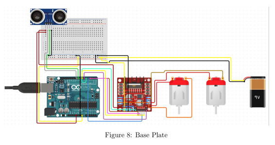

For our robot to avoid ledges we used an ultra sonic sensor to detect falling edges of tables, another Ultrasonic sensors would help the robot to avoid obstacles on the table however due to our limited time con straint it was not installed however the process of it would be the same but given different parameters within arduino IDE. The DC motors were connected to the arduino board using an L298n H-bridge in order to control the wheels individually as well as use them together as well as allowing us to control the speed of each wheel individually
In order to have the right amount of torque a simple calculation was done to ensure the motors would be able to drive our robot. Tw = r× M× µs× g /4

The Motors are connected to the bottom of the frame using 3D printed mounts held by screws and bolts as well as the ball wheel in bottom front of the frame along with the cleaning brush which is connected in the bottom middle of the frame with 3D printed mounts and small MDF wood. The Controller unit(Arduino board) and the L298n H-Bridge were at tached inside the robot along with 5 9V batteries, 4 to power the motors and 1 to power the controller unit, an ultra sonic sensor is installed in front of the robot facing downwards to detect falling edges should the detection distance rise.

• Solder and attach wires from motors to the L298n H-bridge
• Wire all the outputs to their designated pins provided in the code section • Solder and attach a 9v battery to the arduino along with a micro switch
• solder and attach four 9V batteries to the H-Bridge along with a micro switch to turn on the motors

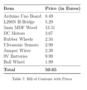

 our final bill for everything we used in our project came down to 50.65 euros which is a quarter of our allowed project allowance.
