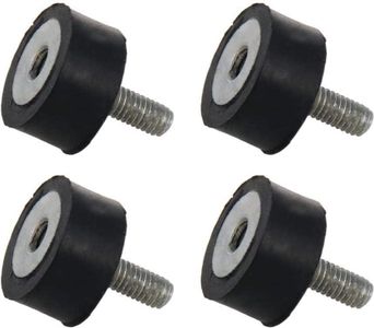

- 14 x Rubber damping block (the import thing is that they have M4 hole ) Amazon link

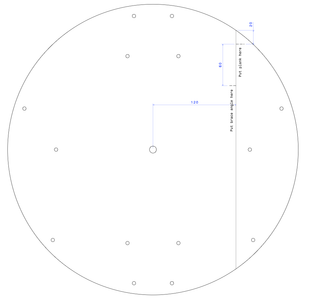

Step 1: Plans, Pictures and Global Intruction for CNC Cutting
I will detail each step of making the taiko by hand, but you can have an overview of every dimension here. For people that want to CNC cut the taiko you can find here the SVG.
Here you have also some picture of the final project without the cover.
Keep in mind the final product in order to achieve each step with the best result

Step 8: Hole Drilling
Now you can follow the template on step 1 to draw the different place where you will need to drill the different button plate.
Place nicely the button on the main plate (follow image tooltip), secure both plate on the table with clamp and you can drill through both plates at once with a M4 drill.
Repeat this step on each plate.
Be sure before drilling hole that the inside/outside button of each side fit well by pair. (the best way to ensure this is to put the 4 buttons in the final position they will have before doing any drilling)
Don't forget to countersink each button hole in order to make the bolt unoticeable.
Lastly, drill a last M5 hole or superior in the center of the mount plate to make a passage for cable.

You can now put the 14 damping blocks on the mount plate and after screw each button on top. If you have follow each instruction, it should be seamingless.

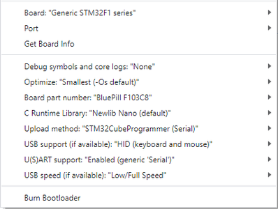

Step 21: Installing Arduino IDE and STM32 Flashing Program
You can follow the tutorial on STM32Duino Github to install the right dependencies to flash the code on your STM32 microcontroller
Step 22: Modify the Parameter
Be sure to have put the right analog input for your project
Step 23: Flashing Parameter
Like said in the tutorial linked on the step before you need to install STM32CubeProgrammer in order to flash the program.
