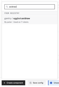

On the bottom left of the page, click the button that says "Create component" search "Axidraw" and add the result named "gantry / eggbot:axidraw". Click "Add module". Name the component "axidraw".

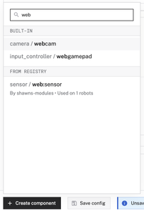

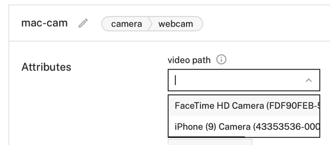

Next, add a camera by clicking the "Create component" button and searching "webcam" and add the option labeled "camera / webcam". Name the component "mac-cam".' In the attributes section of the webcam component card, there should be a pre-populated dropdown with your mac's webcam as an option, select it.
If this option is not appearing, please check this your Mac is running the viam-server from step 4 and is showing up as live. Alternatively, you can find the unique ID to be used as a video path by running the following in terminal. Read more about this method in the using video_path documentation.

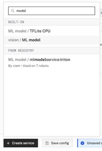

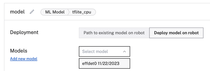

First, we need to reference the ML model which you previously uploaded. Click the "Create service" button in the bottom left of the screen and search "tflite_cpu" and select the option named "ML model / TFLite CPU", name the service "model" and click "Create". In the service card, switch the deployment type to "Deploy model on robot", there should be a pre-populated dropdown with a single option of "effdet0-[date-of-upload]", select it.

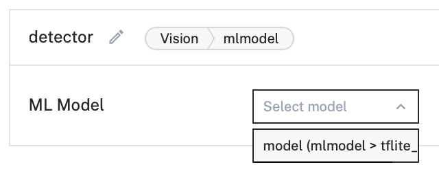

Next, we will be creating a vision service detector which will actually be implementing the ML model. Click the "Create service" button, search "model" and select the option named "vision / ML model", name the service "detector". On the newly created service card, there should be a ML model dropdown with a single populated model option, select that.

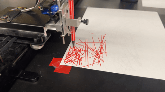

Your Axidraw should be making generative art!
Step 13: Output
Depending on how many people your ML model is recognizing and how long you let the program run for, your output should look something like the above.
