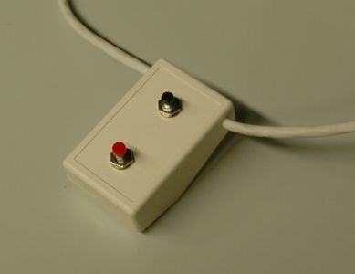

First step is the construction of the joysticks. In total you need twenty of them, for each team ten connected to each other.
The schematic diagram above shows the interconnections.
The joystick construction is rather simple. It consists of a string of resistors which are switched on or off by the players.
Each player has one small box with two buttons, a normally on black push button to move the bat up. A normally off red push button to move the bat down.
A resistor of 1k ohm is soldered over the switches. When no button is pressed the total resistance of the box is 1k, (1k of the red button + 0 ohm of the closed black button).  When the red button is pressed its resistor is shorted resulting in a total value of zero ohm. When the black button is pressed (opened) the total value is 2 kilo ohm. By connecting ten individual joysticks in a string, the total resistance ranges from 0 to 20k ohm.
Note that when one team member presses the red button and the other one a black, the action is canceled out, which is the main idea of this project.
