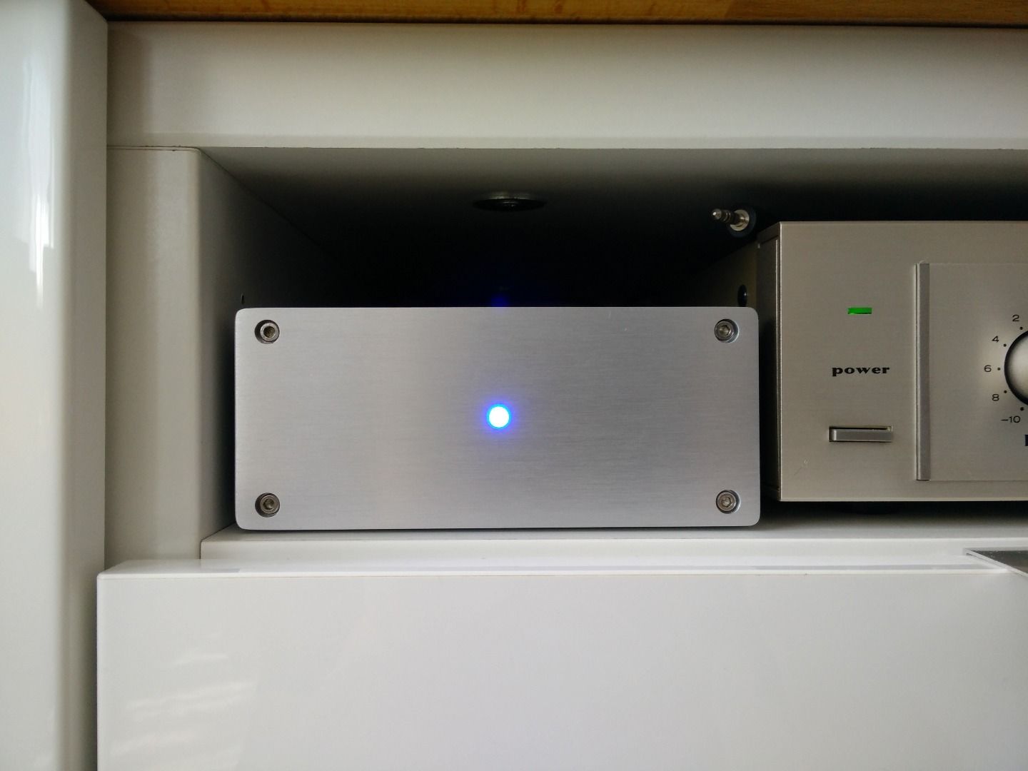

Step 3: The Case
The case is made of 4 thin L-shaped plastic profiles glued and riveted to an acrylic board.
All the components of the box are glued with epoxy.
Four 120mm holes are cut in the acrylic to fit the fans. An additional hole is cut for letting the thermometer cables pass through.
The front panel has a power switch with an indicator light. On the left, two holes let the front panel cable and the USB cable go out. An additional reset button is added for easier programming (the Pro Micro doesn't have a reset button, and sometimes it's useful in order to upload a program onto it).
The box is held up by 4 screws passing through holes the acrylic base.
The front panel is made of a brushed aluminum panel, cut at 19" in width and with a height of ~4cm. The display hole was made with a Dremel and the other 4 holes for screws and buttons were made with a drill.
